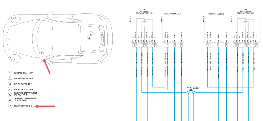

My passenger side cooling fan is showing some erratic operation - runs on high when I start the car in the morning, runs for a few mins when I turn it of, sometimes runs while driving without a good reason for it, etc.  Error code is P0480 Fan Control Driver. Could someone please give me the part number for the fan control module for a 2013 C2S  and let me know where it is located? For some reason I can't find it. Also, does anyone know where the fan relays are located? Would like to swap left and right just to make sure it is not the relay.

Any idea how to fish them out?  I see them but it almost looks like I have to remove the dash. Does the harness flip down so the relay can be removed? Looks like I have to pull it up to get it out. Looking a cluster of 3 relays and a larger computer box or some sort.
