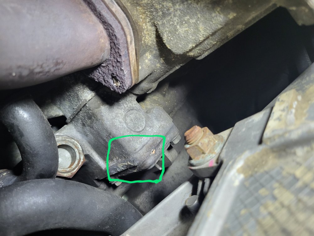

coolant leak - exhaust area
If you look at your picture carefully, you will notice that the "crust" deposits look like they start higher up and run down to the bottom, which is normally the way leaks work, so your leak may be further up and running down to that point, where it dries out and crusts.  I would clean off the area and regularly check to see if you can spot the leak source.  I would also consider adding a bit of Uview's coolant dye, which allows you to use a "black light" source to pinpoint the exact source of the leak, as even if it dries out, it leaves a trail back to the source:
Good afternoon,  I checked the area and up from it, although the oil cooler is up from there, I did not see anything with green Mark or wet fue that matter. Do you know what piece is in the picture? Looking closer it almost looks like there are 2 pieces that it's leaking from there.
Daniel
This is a cooling water channel, the cover is secured with four bolts. The metal seal between housing and cover is leaking and needs to be replaced, this occurs regularly. The work is easy to do, drain cooling water, clean the edges of the housing and cover, replace the metal seal, refill cooling water. Please note, to avoid filling and venting problems cooling water must be refilled with a vacuum device, this is very important to avoid an overheated and therefore defected engine.

That sound good, I will into that and get the metal seal.
I do have that vacuum system, and now wonder if this would cause a vacuum leak, as the last time I replaced the water reservoir it was very difficult ( more like impossible) to keep a vacuum.
@JFP in PA I will get under car and add some pictures. When I do the job, I may as well add pictures from that.

I think I  found the parts in Pelican website only thing is  I see 2 bolts not 4.
Cover:
https://www.pelicanparts.com/More_Info/99610101600.htm?pn=996-101-016-00-OEM&fc=Y
Gasket:
https://www.pelicanparts.com/More_Info/99610133650.htm?pn=996-101-336-50-M30&fc=Y
