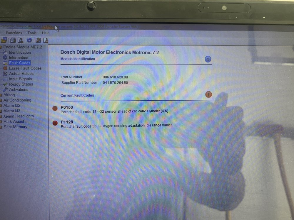

Ok so my CEL came on again today. I’ve been trying to get a long enough cycle on the car to pass emissions. I think this time it’s something different then the problems I had before replacing my AOS. Those errors seem to be fixed. Is this something as simple as replacing my O2 sensor. I replaced the secondary O2 sensors not too long ago. Are the O2 sensors the same for pre and post cat?  I’ve attached a image of what my Durametric showed.
No, not all O2 sensors are necessarily the same; some have different length harness connected to them, others different connector plugs (rectangle vs. oval).
Both codes are ones you have gotten previously, P1119 is often a harness or electrical issue; diagnostics involve checking the heater resistance (ohmmeter between pins 1 & 2 should read 1.8 - 2.5 ohm) and pin 1 to the sensor housing should read infinite ohms.  If that is good, the next step is to chase the harness back to the DME for continuity or shorts.
So I ohmed out the O2 sensor on  pins 1 and 2 and got readings of 3.8 ohms. I got the same readings on both the pre cat sensors. Does that mean they are bad? I have some different codes today posted below.
