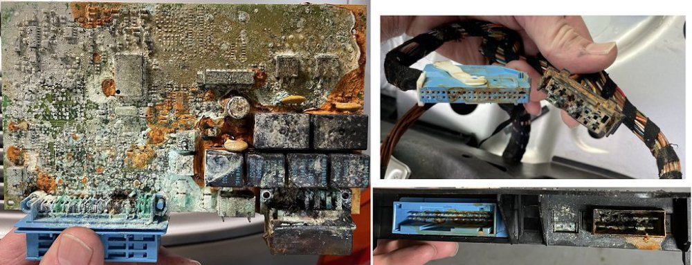

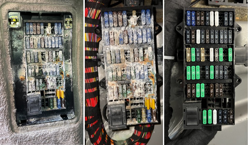

In the first post I included the service values report from the PIWIS and also a link to another thread that covers a lot of what has been done. It's not like I came home with it and said "let's see if it runs". I Immediately gutted it and started looking for and repairing damage. All modules are found by the PIWIS and the report shows what was found. The reason I didn't mention that it was flooded is because responses like "it's a paper weight", and "good luck" aren't helpful and a cop out for people who can't handle a serious challenge. Here's the paper weight BTW, are you sure it was bad?...

No, it was not a "cop out", and came from someone whose shop has faced multiple submerged cars for customers and insurance adjusters.  The fact that it was under salt water would have changed my entire approach, starting with replacing the harness and possibly several sensors known to be problematic after submersion.  We have seen cars that were in both fresh and salt water, and the latter were always the worst, and often not recoverable in an economically feasible manner, which is why the insurance companies wrote them off.  And of the ones that were salvable, most continued to be plagued with a wide variety of problems related to the immersion for years after they were put back on the road, which is why I said, "Good Luck", and why we regularly caution parties potentially interested in cheap flood cars; they can become black holes for money with little resale value.

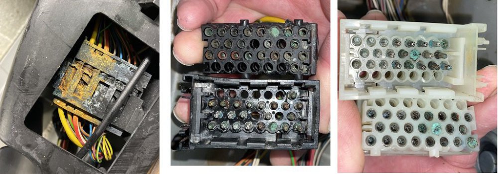

The X2's were a big ball of green, this is after cleaning up enough to finally get them apart. Before I replace the entire harness I'm going to replace all of the connectors that I had deemed good enough. After discussing how sensitive the CAN bus is with the Indy techs I've decided my good enough was no where near good enough. I repaired broken wires and pins then soaked them in a mild Hydrofluoric acid solution. This did a great job of removing all corrosion but also removed the tin plating. So now the copper is corroding quickly.

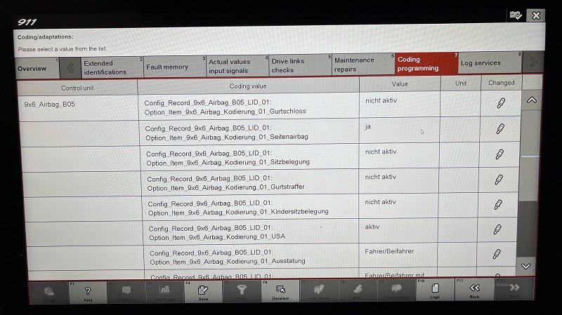

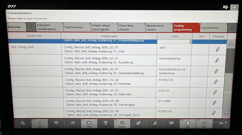

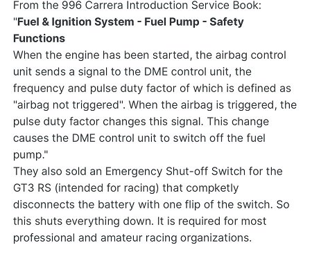

Can anyone say with certainty that the Airbag module can or can't be used in a car other than the one it was locked to? I've seen post saying no it's VIN locked and others saying they used one with no problem. I know this can shut the fuel pump down in a wreck, so I'm wondering if it might have my fuel pump shut down because it is not the original one for my car. I will say from what I've seen, it doesn't appear to be a VIN lock, I think it's locked to the model. I looked at all coded values with the PIWIS in engineering mode and didn't see VIN in there. Just for giggles I told it to lock it and it flashed Model 996 right before it said it was already locked. Those two things lead me to believe the lock is on the model not VIN. Also, it is error free, and it automatically found my two new igniters in the door sills.
