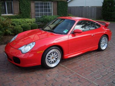

BTW, the Mintex Red Box pads are on and the Wheel Wax is applied to the BBS mesh style wheels, so we'll see how that works out for clean-free wheels.
