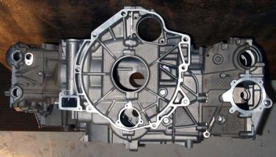

Hi guys, I appreciated any info where to look visually (Pics) for a RMS leak. I had a RMS leak in the first 1.5k in my Box S now(48.5k). The oil leaked into the clutch componets and the clutch started to slip and get stuck in gear. The car seems to be headed in that same direction once again (clutch slipping). I wonder if this is the same problem because I am pretty good driver as far as operating a manual transmission correctly. Thanks.

sorry - no RMS picture
