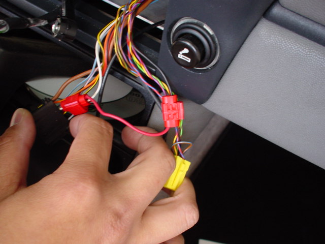

It's a direct replacement, however it's not playing any audio through my speakers when I plug in the yellow speaker connector. Could I be wiring this up wrong? I don't see how, and when I plug the CDR 220 back in, it's fine.

No sound because there is no power to the trunk amp.
Easiest way is to use a jumper wire from a wire on the black radio connector to a wire on the yellow connector. The the amp will turn on and you will get sound.
When Pat did his traffc pro he used scotch-locks/wire taps, or whatever they are called.
BTW I made a quasi adapter using Bekker pieces as I run an aftermarket amp and I did not want to tap/cut my harness. All in total there are two harness adapters and it was not a big deal, save that the remote turn on is actually a different wire- contact Bekker for the adapters-

I got a call back from Becker alerting me that if I jumpered from A6 to C5 and left A6 connected, I would be doubling the voltage going to somewhere and it would burn out the unit.
I opened the dash up again (am getting fast at this part) and removed the head unit, cut and nothing. No sound. Checked, re-wired, nothing. Jumpered it back, sound. Frustrated, I went back and forth like this. Finally, I had sound and re-neatened the wires, slowly pushed the head unit back into the dash and heard a buzz sound. Smelled smoke too. Pulled out as quick as possible and much to my chagrin.... You guessed it - fried the nav portion of the head unit. Seems that the chassis made a short with the GPS antenna wire.
