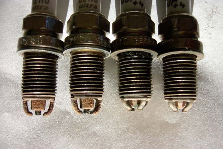

In the past there has been discussion of what plug to use and some concerns were mentioned about the Bosch Platinum +4 (part number 4417). I ran these in my car (1998 Boxster) for the last 30K miles after having run the stock Beru plugs for the first 30K miles. I have attached pictures of both plugs. I did not have any problems with the Bosch plugs. They appear pretty much what I would expect them to look like after 30K miles. YMMV.

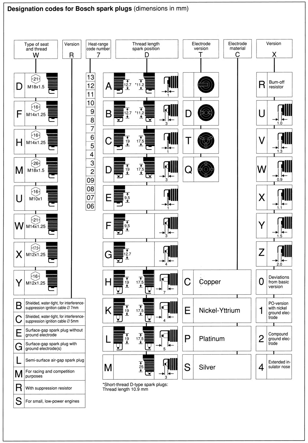

Does not the 7 in 4417 mean heat range 7?  The Bosch site lists the 4417 and the FR7LDC4 (the stock plug) as equivalent.
The 7 in 4417 does not represent the heat range. The Bosch Platinum +2 that's called out for the Boxster is #4303, but the last 3 is not for the heat range. The 4417 fits as far as size goes, but it's not the same plug as or equal to the OEM FR7LDC4. The OEM FR7LDC4 plugs are copper, not platinum. The 4 digit numbered plugs are just an easy lookup number for the end user at an auto shop for the plugs sold retail and have no real meaning.
The FR7LDC4 means:
F=Seat (16mm), Threads (M14x1.25)
R=Version (With suppression resistor)
7=Heat range (7)
L=Thread lenghth (19mm) spark position (5mm)
D=Electrode version (2 electrodes)
C=Electrode material (Copper)
4=Version (Extended insulator nose)

If the 7 does not indicate the heat range what is the heat range for the 4417 and 4403? I cannot find that info on the Bosch website and the plug only has 4417 stamped on it. As Bosch recommends these plugs along with the FR7LDC4 it seems logical to me that they are also heat range 7. It would be nice if someone could reference a source of more definitive information.

My original intent for this thread was to "refute" the less than favorable press about the 4417s.  I appear to have gotten 30K miles out of them without anything falling off of them or any other ill effects.  YMMV
      Again, that you know of.  But, as I said, the plugs (Bosche) did not have the proper color for a correct 14:1 Air/Fuel ratio (this is a very static indicator and doesn't change one plug for the other, or one engine for the other for that matter). You claim to have experienced some trouble codes - cause and effect?
I have included the Bosch designation code(s), but the Platinum +4 and +2 don't follow these guides, as you mention. I have sent an email to their Technical Dept. and will report back on their reply. See attached.

The fact is you have made a claim that using the 4417 plugs for 30k mi. had no ill effects.
I stated that the plugs do not have the correct color for proper combustion, an ill effect in my book.
Granted a sparkplug is a Snapshot in time, but this is the picture you have. Does the CEL issue explain it away? Plugs take on the effect of the A/F mixture near instantaneously and will change as the conditions do. If the CEL issue was corrected, this should be immediately seen in the plugs (within 5-10 miles).
All I know from the pic is that they are running Hot, perhaps due to a lean condition, perhaps due to improper Heat Range, or both. Plugs have basically 3 classifications: Good, Fouled (Cool), or Hot . Neither you nor I can say that the plugs weren't that way all along.
Also, I am somewhat disconcerted that Porsche specifies a Heat Range for the various Models, Markets, Engines, etc., but Bosch seems to spec this plug to run the whole gamut, including many other engines and makes. I don't agree with letting the plugs go 30k mi., but that is debatable.
As I stated in an earlier post the car was running lean when the plugs were taken out and before the MAF was replaced.  Now that the MAF is fixed I suppose I can put the 4417s back in to see if the color changes.
