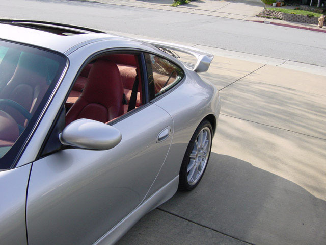

When the sideskirts are done properly there should be no gap at all. That is, you can not even slide a piece of paper in the place where they meet. The later version of sideskirts Porsche sold had two-sided tape where as the early version was put on with epoxy. I think one of the complaints was that the epoxy version needed to taped and held in place for 24 hours before the car could be driven. The later version of the double sided tape does not seem to to hold as tight as the epoxy - IMHO.
Here is a picture of my factory epoxied sideskirts.
