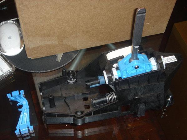

Supposedly for 2005, the Porsche OEM sport shift is different from the B&M, which is why I asked the question. See Rennlist discussion with pictures for a side-by-side comparison. Other posts in the same topic led me to believe the 997 OEM short shifter wasn't as short as the B&M. The pictures of the 997 shifter look like it's blue plastic, and not the black metal clone by B&M.
Has anyone actually seen and/or installed one of these new ones to confirm the differences? Brandywine is telling me the new Porsche short shifter is a lot smoother and easy to shift than the B&M everyone is using

The short shift Porsche came out with for the 997 is different. From the pictures it is blue plastic, part number 997 424 983 00, and is the same shifter used on the 987. It is in the first pic, and let's call it the new style Porsche short shift.

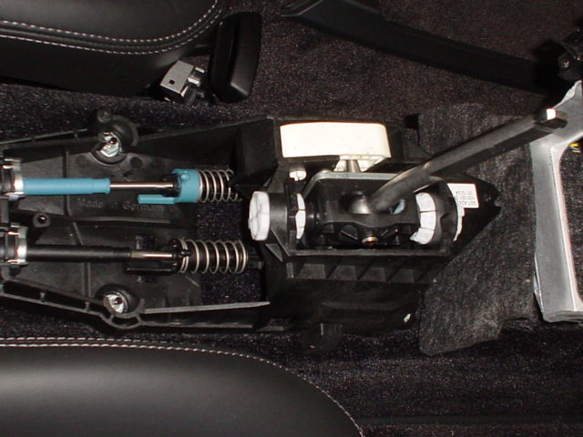

I too have wondered if the new style would work on a 996/986. I have seen the standard 987 shift tower and it sure looks to be the same dimensions and mounting position as used in a 996/986. The second pic is the 987 standard shift and you can tell because it is black plastic. Other than the shift lever itself the 987 unit looks just like what is used on a 996/986. Same black and blue cable connectors. Same type of mount on the rear of the tower for the cables. Same 4 nuts to hold it down.
But I have never seen them side-by-side to be a 100% sure the new style Porsche short shift will work with a 996/986. I guess you will just have to trust Brandywine.

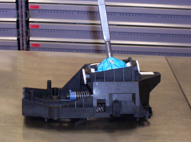

The third pic someone took of the tool to adjust the cables. I think it comes with the shifter, but Brandywine should be able to look in a box to be sure.
