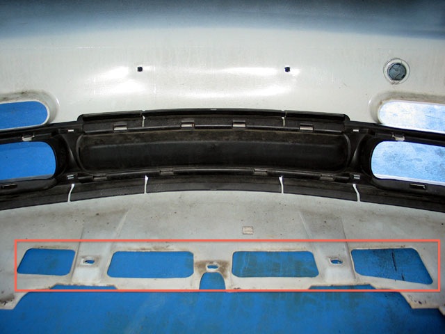

Gentlemen
I have a related question to this install.
I have a GT3 RS front bumper. The one with 3 cutouts ABOVE where the centre radiator would fit.
I notice that cars with the centre radiator have outlets cut at the BOTTOM of the bumper. I guess given the angle of the radiator when installed that this is to vent the air out of the bumper enclosure.
My question is this.
Do you think it would work for me if I installed the 3rd radiator and DID NOT cut out the bottom of the bumper.
Car in question is a 2002 996 C2.
Thanks in advance
karl

If you install per my instructions (in the DIY) you will be fine.
Hi Loren
Thanks for the response.
Not doubting at all what you are saying but I do not have the cutouts per the picture attached.
Apologies but I used the picture from your DIY and put a red rectangle over what I am referring to.
I am really not sure what the effect would be if I did or did not have these cutouts.
Thanks in advance and regards
Karl

Loren
Apologies for the very very delayed reply.
As always thanks a million. I researched some more after what you told me and realised there are different shrouds depending on which way the radiator is positioned and which bumper.
In the interim I've cleaned out the radiators, put the bumper back on and installed my ROW M030 suspension.
Not I will have to figure out the correct shroud.
