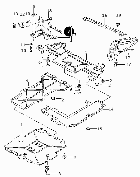

The picture you pointed me to are item 4 and are removed from the end of the bumper when you add an aerokit.
Perhaps you mean the air guides at the bottom of the wheel well liners? (items 7 an 8)

The part I want is shown here:
I think you want item 7 in post #2 above.
Left or right -- or both?
both please.
996.504.393.01
and
996.504.394.01
correct?
