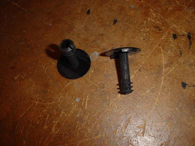

Does the plastic cap look like this?
Yes, that's the cap alright, sure caused me a lot of trouble. What is it? So, sounds like I will have to get a dealer to reset this light?

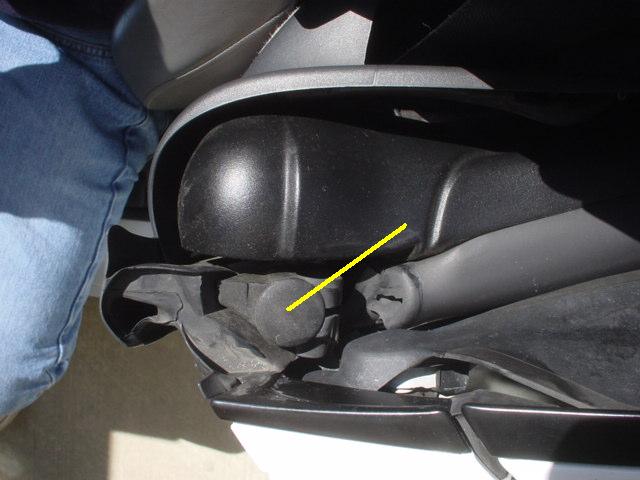

Thanks for the info. I will try to find a local shop with a PST2. Any idea what the plug is (picture in tool pants response)?
Lucky guess.
Your lucky guess was right on the money. Good picture but I can't tell what the plug is for or what area of the car I'm looking at. Can you enlighten me? I wonder if the drain was plugged from the factory, the previous owner said it had never been in the rain and I guess he was right. Still you would think he would have noticed a problem just from washing the car. I've only had the car a month, sure is nice to have some of you guys to talk to on this forum.

For some strange reason that plug is able to jump out of the socket for the spinlock hole. The plug is then either lost in space, or finds it's way under the top near or in a rain water drain hole. If a drain hole becomes blocked then water can enter the cockpit.
When I meet a new owner and one of the plugs is missing I look under the top for it, and 1/2 of the time there it is. Under the top, next to a drain hole. The other 1/2 half of the time I cannot find it because it is lost in space and flew out of the car.
The plug is not an "umbrella" for the drain hole and it does not belong under the top.
