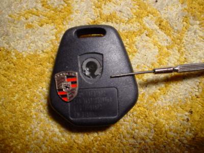

So it took 2 seconds with a jewelers screwdriver. Bling.....
I do not have a 3 button remote to play around with yet to see if there is any difference. The key head in my picture is a 996 2 button.

OK - I couldn't wait for the Ontario tour and bought the colored crest. My black-and-silver one seems stuck on pretty good. Where did you pry up, and did you end up destroying the old one in the process?
And the answer is...
  • Before
The silver/black crest was pretty stubborn and wouldn't come off with a little jewlers screwdriver, so I heated it up with a blow dryer on high for a couple of minutes, and it came right off
  • During
The monochrome and color crests (part number 996-637-443-00) look to be the same shape, but they're not exactly! The new one is less pointy and wider at the bottom of the crest. So I used a jewlers screwdriver to carefully carve out more room for it to fit in the recessed space from the old crest - checking fit frequently
  • After
It's not 100% perfect if you examine it under high magnification, but looks just fine from 4" away. I used some high quality black silicon as the adhesive, since it looked like a little button of clear silicon was all that was securing the original one in. I clamped it for a few hours until the silicon started to cure, and wiped away any excess silicon that spilled out before fully cured. (I pulled the key apart - remote electronics and key blade - when working on it, glueing and clamping to mimimize danger of messing anything up).

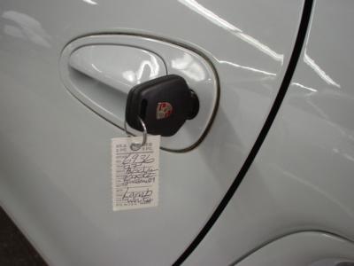

I went to a tech session at a local body shop yesterday. There was a 1997 Box in the shop with the key in the door. It had a colored crest on the 2 button remote.
The 1997 owner did something to get that colored crest.
