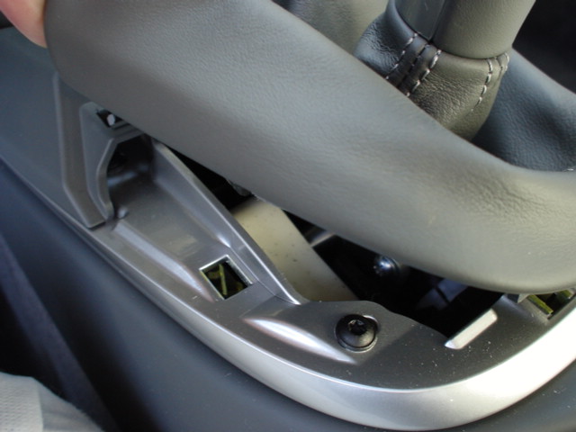

Tool Pants: is this picture from a Boxter ?
In my 997 S , I placed the screwdriver BELOW the chrome ring (between the chrome and the console )and popped the entire assembly including the attached leather shifter boot off together .

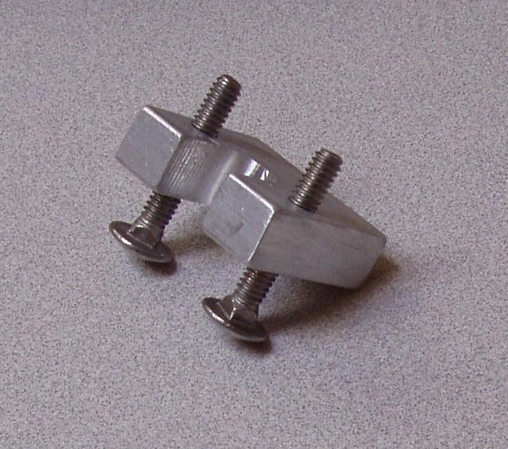

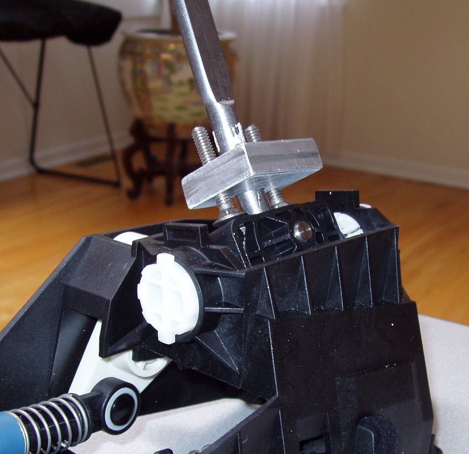

The tool is made from a ~ 2" x 2" x 3/8" thick piece of scrap aluminum.
You notch a ~ 1/2 " wide opening in the middle , just wide enough to fit around the shifter .
Then drill and tap for two 1/4" carriage bolts on either side . (Bolts should be about 1 1/2" long )
You adjust the bolt lengths so that the aluminum plate fits up snugly against the plastic collar below the shift knob. The bolt heads face down and rest on top of the shifter base (see picture )
MAKE SURE THE COLLAR IS TURNED 90 deg. CLOCKWISE BEFORE PROCEEDING .
( I could turn it by hand and did not need a wrench to turn it )
I put a dab of white-out on it to see it did not move while forcing the knob off . Also, I suggest you mark the shaft just below the collar, to give you a reference point later , to see how far down on the new shaft the knob has to go and finally , also mark the cables so you have a starting point when re-attaching them .
Then all it takes is to give the bolts ( alternatingly ) a few clockwise turns with a wrench , basically backing them out of the aluminum plate.
Since the bolt heads cannot go down , the plate has to go up
" breaking " the knob loose.
(It only has to go up about 1/4 " or so to loosen the knob )
Someone else may have a better idea , but this worked for me .

My picture is a 987 Boxster. I thought it is the same as a 997.
I watched a mechanic at the dealer remove the shift knob from a 987. You have to rotate that locking collar as stated above.
Then the mechanic stood on the seats. One foot on each seat. Then he reached down and pulled the knob off. I do not know what is going on with the new knobs but they seem to take more effort than a 996/986 to pull off the metal shaft.
That was very creative Jean, I must say.
Thanks for the idea, I actually used a similar principle to remove it.
I wrapped a piece of cloth around the shifter to avoid scratching it, then used a pair of locking pliers very close to the collar, and the used another set of pliers between them and pushed them down against the first set to create a lever, and that did the trick.
So it is finished, very cool, I am glad I decided to install it, it's great.
