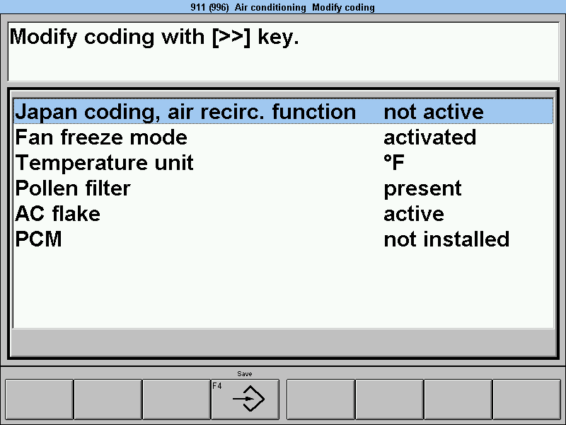

I think your right about the coding....just dug up something in the workshop manuals:
1. Connect and switch on the Porsche System Tester 2.
2. Select air conditioning and menu item "System test".
The following conditions must be observed for the system test:
-Vehicle speed < 10 km/h
-Engine start detected and 10 seconds elapsed since engine start
-Terminal 15 supply voltage OK
-5 Volt supply voltage OK
-Engine temperature < 110 DC
-Outside temperature> 3 DC
The following tests are performed:
-Display of all segments in the control module
-The drive motors are traversed across the entire range once
-The measured positioning travel is subjected to a plausibility test and stored as a fault if necessary.
-Two different voltage values are set on the fresh-air fan and tested
-The A/C circuit is tested via the DME All fault paths are tested, and any faults are stored
-Basic adaptation has been completed after the system test. The display must no longer flash.
I guess this explains the LCD flashing. I'll borrow a PST2 & give it a try.
