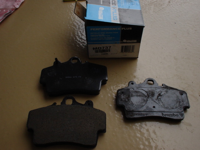

If you get down to the San Jose airport there is Intex. They sell pads made by Remsa for about $40. These pads are repackaged under different names, such as Qualitee. The friction rating for the base front is FE. They have the holes for the sensors.
We have put these pads in a local 2.5 and the owner likes them.
