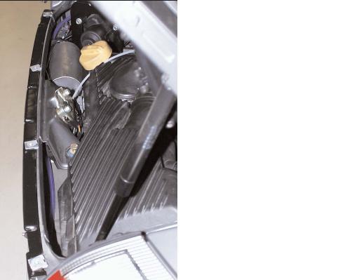

The Gemballa tank can be seen left to the oil filler cap on the photo. The stupif thing about the set is that the gender of the hoses and connectors are reversed compared to the OEM stuff. So the y-connectors are male (small diameter) and the hoses (which are silicone) are big which makes them incompatible with the OEM parts.
