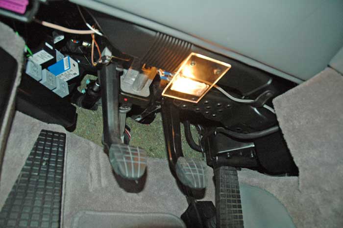

I added footwell lighting to my 996 with 2 lamps from VW (the same ones that are used in the trunk and engine compartment) and a power line that runs up the A pillar across the windshield header to the center dome lights. I fabricated a little bracket for each lamp to stick them under the dashboard. Pieces cost about $10 and 2 hours of time.

I took the power from the center top dome light because it was the simplest thing to do. The A pillar cover just pops off, and the windshield top header cover comes loose by removing the sun visor. The dome light is held in with 2 screws that are under the little alarm sensor covers.

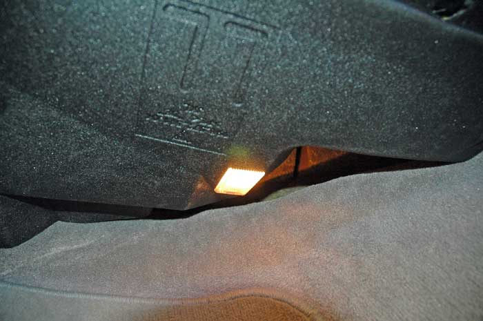

Inspired by this post I started my install last night, drivers side is done, it is using a lamp with three ultra bright LEDs in it stuck under the dash and wired to the dome light. It looks brighter in the picture than in real life and also white rather than blue, it's nicely subdued in person. Total cost < $10. Carpets need a clean...!
Lights off:
Lights on:
Chris.

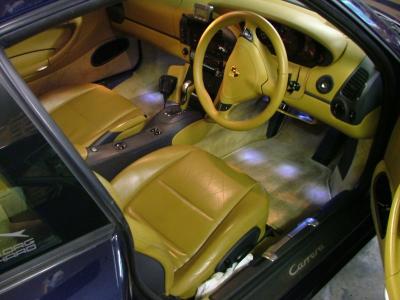

Inspired by Chris, and using the same LED's that he used, here's what it looks like on a 996 coupe:

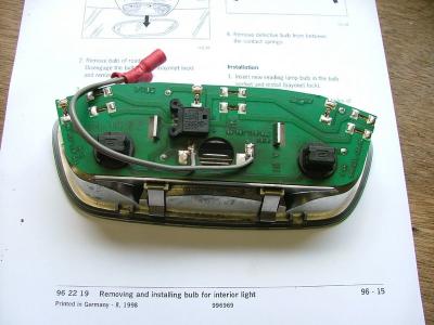

The only minor modification to original was soldering the wires to the circuit board of the interior light:
Looking at the connections in the picture, the one on the right is earth, and the one on the left is 12v.
