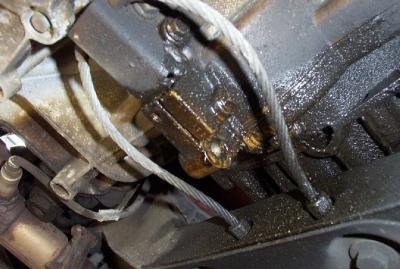

There are many places where oil can leak from the engine. A common source is from the cam covers.
If it is from the rear main seal or intermediate shaft seal then you will see oil in the area in the picture. This is where the transmission bolts to the engine. Where the cable is.

That looks a lot like the underside of my engine. My guess its the RMS. At 55K now, do I need to be that worried about a few drops of oil per day (maybe two drops per day)?

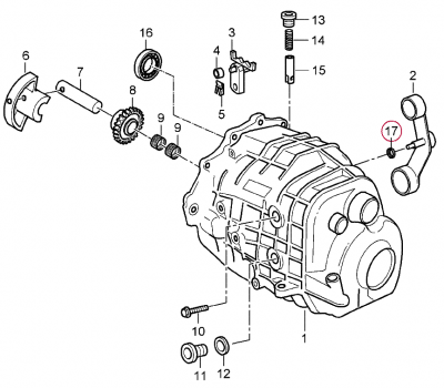

Looking for help with an oil leak that I have been troubleshooting for most of the weekend. It is coming from the gear shift linkage shaft were it enters the gearbox bell housing (area circled in red on the picture). Oil is visably dripping from the linkage counterweight (circled in blue).
Is there a replacement seal kit or ???? for this problem.
Thanks in advance for any help.
Chances are the transmission will need to come out for this repair.
Are you sure the transmission is not overfilled?
Item 17 - 996.303.517.01 shaft seal 15 x 21 x 7 -- US MSRP $5.18
Thanks for the reply Loren. Yes, if the seal is gone it is a case of removing the transmission, item 2 on the image is a fully fabricated item, the fastener for which must be internal.
I have not checked if the transmission is overfilled. Is this a common issue from the factory? I am the second owner of two years and have all of the records for the car and none show any transmission related items.
How do I check for correct oil level, do I just remove item 10 or 11 and see if any seeps out?
Your car is a MY2001 - I would hope the transmission oil has been changed at least once in 7 years. ;)
Yes, remove item 11 (while the car is level) and see if any seeps out.
Good point Loren, I will check the level. The car has always been serviced at the dealership. Should they have changed the transmission oil as part of say a 3 year standard service or do they leave it till 60,000 miles or so?
Unfortunately no oil seeped out of the plug, so it's doesn't appear to have been overfilled. Thanks for the idea though Loren I hadn't thought of that. Pity, that would have saved a lot of time and money!! Looks like it's seal replacement time. Any idea of how big a job this is. Is there any special tools required?
