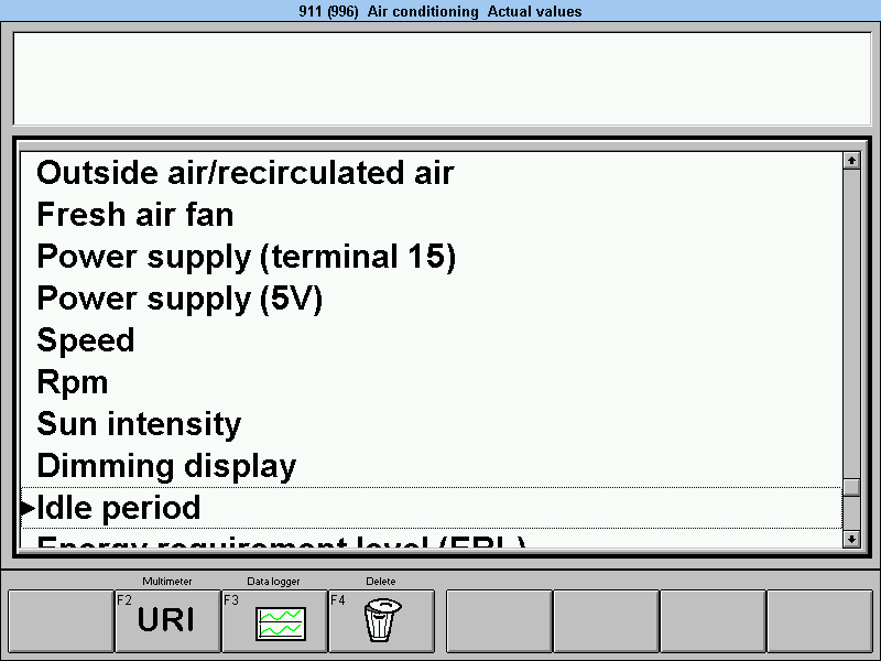

Find a shop with a Porsche PST2 or PIWIS tester and they can diagnose the cause of your problem in few maninutes with just a few tests.
Loren, how much does that cost where you are? just want to get an idea before I call a local
garage.

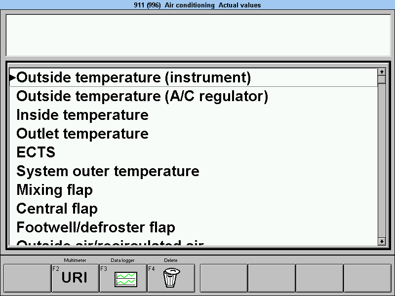

You can read a number of actual values.

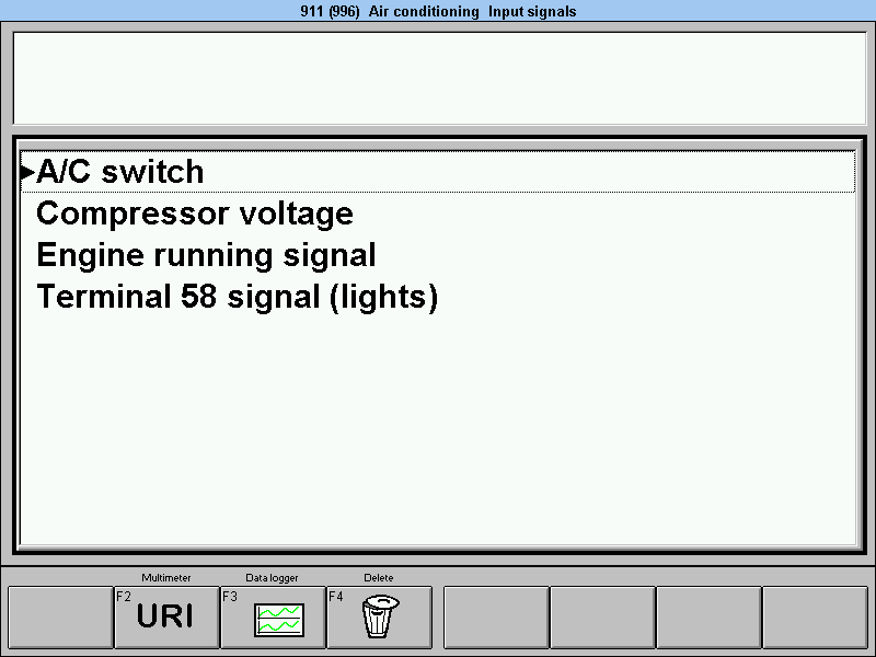

You can look at input signals.

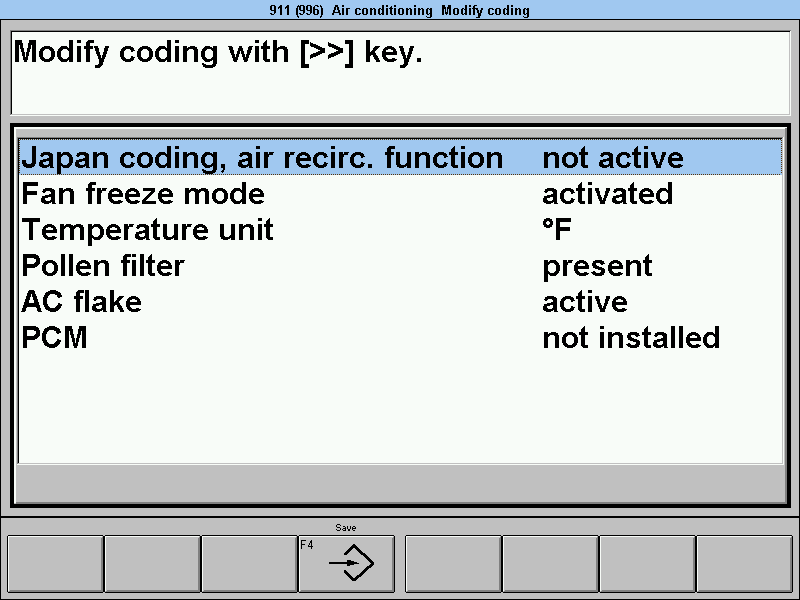

You can verify/change coding of the AC system.

PS Thanks Loren for the screenshots, very informative.
