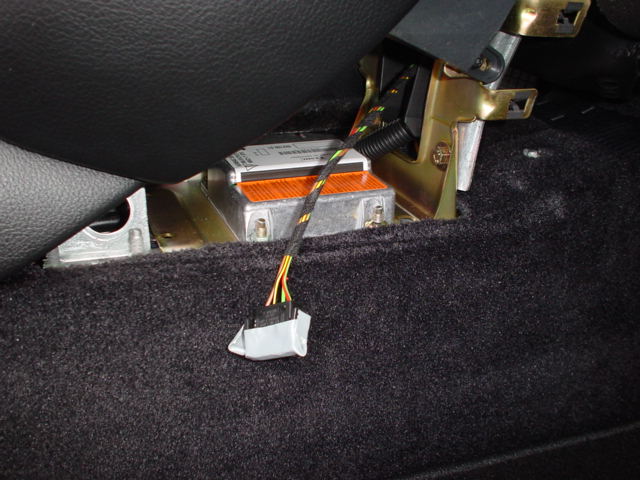

Pull off the right trim panel that is covered with carpet and you will find the connector. Starting in 2003 Porsche put tape on the end of the connector. We tap into those wires for power. If you want to get fancy you can buy a cell phone connector from Becker that plugs into the existing connector. Loren has posted the color codes for the wires or you can check them with a volt meter.
Thanks, Tool Pants, that was easy! I found the connector by sliding the cubby out. After connecting the power, I made an opening in the top of the upper cubby I bought (on Ebay) in place of the CD holder (which I no longer need). The iPod just lies in there, but it's quite easy to change tracks, and I don't have to turn it on or off as it's wired into the ignition. If I feel like spending more time and effort, I'll upgrade to the iPod Mini and build some sort of cradle for it.

Also, DFC, I bought a cigarette lighter extension from Radio Shack, cut off the end, added some solder to the wire and pushed them into the connector (black into brown wire, red into green wire), then covered everything with electrical tape.

Found it
Telephone prep connector. On it you will find:
+12 volts unswitched (red/green)
+12 volts switched (green/black)
Ground (brown wire)
Telephone Mute Signal (yellow/black wire
( from Loren's post)
