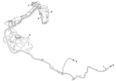

So I replaced the MAF and the fuel cap. The P0102 hot film MAF error code went away but the Tank Vent Leak code (P0442) came back in a couple of days. Does anyone know where in the technical manual I can find some more information on the piping? I can try to follow that piping/system to see the source of this error ...
Thanks!
Sid
Edited by siddharth
1 - EVAP canister purge valve
2 - EVAP canister
3 - Purge air
4 - Tank
5 - Pressure sensor
6 - Shutoff valve
7 - Operating purge valve
8 - To intake manifold
9 -Vacuum control valve
I sent you some troubleshooting...
