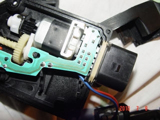

Mike:
When the window goes back up that 1/2 inch while the door is still open, the problem is usually caused by a fault in the door lock assembly. Sometimes the connections or the microswitch will be intermittent or one of the wires leading to it has become chafed or pinched (and thus causes a short) and sometimes the solder connections inside the assembly crack or come apart. Porsche only sells the complete assembly (censored.gif), but you can take the housing apart carefully and resolder the connections. One poster on 986forum ("Jinster"), who also posts here was even able to re-flow the solder to those joints WITHOUT taking the housing apart.
Here is a photo of the inside of the assembly (courtesy of "sb01Box"):
post-6627-0-67210500-1292427806_thumb.jp
Regards, Maurice.

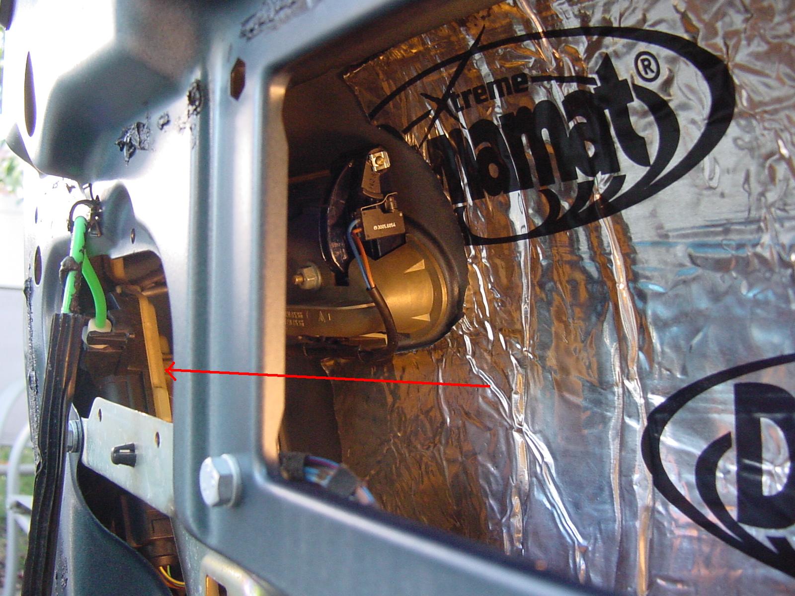

Where is that assembly -- is it behind the door panel -- back along the end of the door?
I've taken a couple doors apart -- but its been awhile and it was for something else (broken cable)
thanks,
mike
Mike:
It's behind the door panel, here (click on the photo to get a good look):
post-6627-0-91191500-1292440285_thumb.jp
Regards, Maurice.

There are two microswitches - one on the inner door handle, one on the external door handle. Maurice's picture actually also shows where the external handle microswitch is attached. The internal microswitch position would be very obvious once you open the panel. Either of these could be faulty/loose. Just disconnect one and then the other (or both) to diagnose your problem.
Another failure point is the connector at the door lock mechanism - wiggle it at the connector and see if you can reproduce the problem.
This won't be too hard at all.
There are 3 micro switches on each door to be correct, 1 on outside handle, 1 on inside handle and 1 inside the door lock. The one build in the door lock is the most vulnerable in the system.
My post does refer to a third "failure point" inside the door lock mechanism itself. I am just not sure if there is actually a physical microswitch inside the DLM. It's certainly a "microswitch by principle". The DLM would sense if the door is open - by the way of the switching plate's position - one can simulate a door closed position by manually flicking that switch plate in the exposed part of the DLM when the door open. I am just not sure if the flick of that plate actually actuates a microswitch. It's probably a direct switching effect. But the result is the same. And the DLM is difficult to service. If the DLM is responsible, the failure point is usually not at this "microswitch by principle" but rather at where the harness connects.
