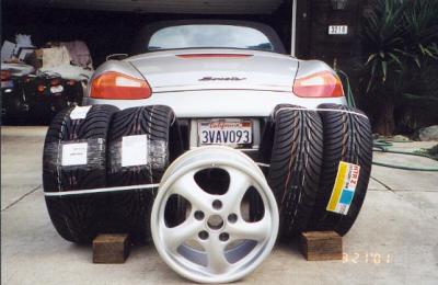

I got 20k miles from the Sumitomo HTR Z II. Did not look like that when they were new. Not much interested in the N rating.
I wanted to try Kuhmo 712 this time around.
4 years ago I paid $484 for the Sumitomo from Tire Rack. It is now $344. Kuhmo cost more.
4 years ago I was told Sumitomo was good bang for the buck, not good in the wet. This has proven to be true in my experience.
So, it looks like I will be contacting Tire Rack for a repeat.

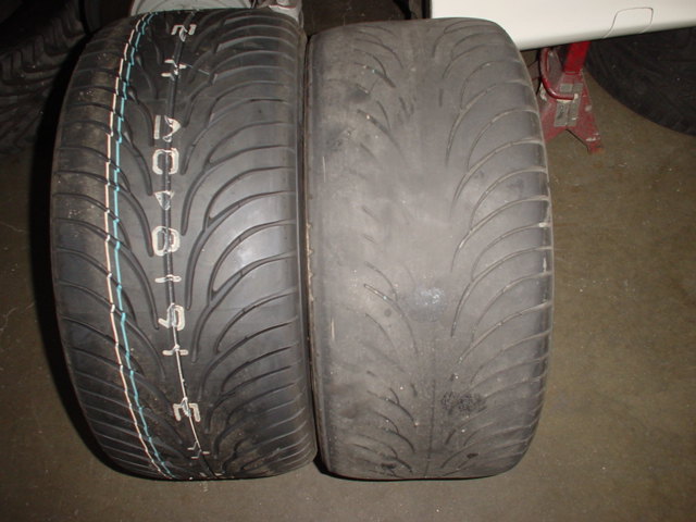

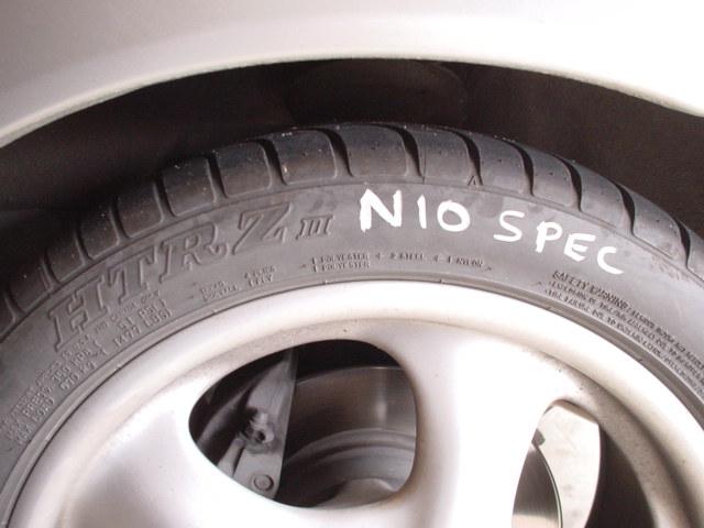

To finish my part of this thread, I did a repeat. Second set of Sumis put on today. So I will get out my chalk and put N11 on the new tires. Wheel Tech presented our tech sesion in January, so Tom the tire installer put on this set just like he did for the first set of Sumis in 2001. He said there is going to be a version III so that is why the price may have dropped. I got my money's worth.
Jeff, the co-owner of Wheel Tech, showed me these short valve stems they have been using. That is what was put on.

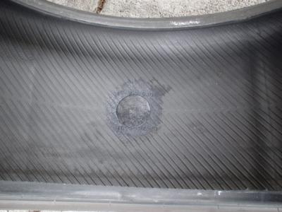

Shortly after the first set of Sumis were new I had a flat repaired with a stem patch on the LR by Custom Alignment. After that tire was remove by Tom I took a picture of the head of the patch. Looked fine to me and I survived for 20,000 miles on that patch.
Toolpants, that's some really ineven wear on your tires !!!!!! Is that normal and what if the wear pattern was reversed (more on the outside) though not as much as what you've got

You are right, that is uneven wear. I forgot to ask the tire guy why. On both rear tires the insides were bald, but the outsides looked fine so I did not know it was time to replace the tires until I looked under the car. When the first set of Sumis were put on I had a 4 wheel alignment done to factory specs and I have not hit anything. The original Contis when the car was new did not wear like that. So where are the tire experts?

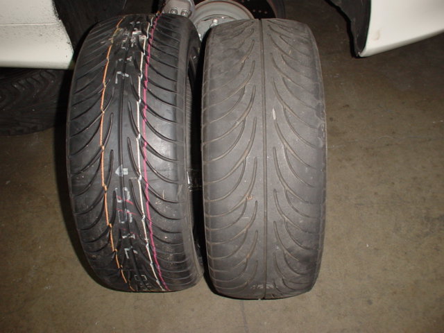

This is a front which has even tire wear.
In any event I will need to replace my power steering rack in the near future so I will at least need a front wheel alignment. I will have a 4 wheel alignment done again and see how the second set of Sumitomos wear.
Just done an all round tyre change on my 986S with Pilot N1s. The rears showed exactly the same kind of wear as Tool Pants' tyres (although they were still legal [sheez Jeff, that was an oversight on your behalf :huh: ]) so I had an alignment check at the OPC.
Everything was in spec, so I presume the correct setup is to have negative camber on the rears (top of the wheels inclined inwards - for the non familiar) so the contact patch of the tyre is flatter in heavy cornering.

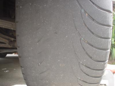

On another topic (uneven tire wear) that I posted, someone mentioned something about the big range in the allignment settings to still be in factory standards (-0.8 to ~-1.5). It does make sense that the inner edge wear faster with -ve camber. But like I said in the other thread ... suprisingly my rears show exactly the opposite. Not by a lot but you could notice. the difference in the tread depth may be less than 1/16" (approx). The service guy at the dealership told me that it could happen if I cornered a lot at high speeds even with -ve camber. Right now really not that concerned as the difference is negligilble. I don't drive much on freeways, just city roads and as fast as possible there (as long as the cops are not around, which is most of the time)
But wanted to know what you "porsche pros" think on this absurd wear pattern? <_<
Edited by the_lonely_guy
Not really absurd. Almost all manufacturers' alignment specs are so wide that basically if the wheels are pointing forward, they will be "in" alignment. To say that your car is within spec isn't saying much. This is especially true with our high performance cars and low-profile tyres :) The camber doesn't have to be off by much for your tires :( to wear unevenly. When I say "off" that is also subjective on how you drive and your preferences for handling versus tread wear. As a rule of thumb, you want more negative camber for improved handling. When your car leans in a corner, the additional negative camber will help keep the tire's contact patch in the correct orientation. The trade-off, of course, is when you're not in a corner, the insides will wear more. You can go even further than what is needed to keep the contact patch in correct orientation when cornering. This will further accelerate inside wear to counter-balance extra wear on the outside if you regularly take corners fast. Another problem shows up if you have too much negative camber and you have a lead foot. Your acceleration/braking will suffer in a straight line. As you can see, there are a lot of factors to consider, so there is no one "right" alignment. The best advice would be to go to a "precision" alignment shop that will align your car to your driving habits and expectations. All this, and I haven't even started talking about toe. As a generalization, Tool Pants could probably stand to run a little less negative camber if tire wear is a concern. the_lonely_guy could probably stand to run a little more negative camber in the rear. Jeff, do you have a lead-foot?
In response to the lonley guy's problem, even if you have negative camber, if the toe on the rear is set for too much 'toe in' - this will wear the outside of the tyres. This is because both wheels are trying to steer inwards, thus scrubbing the outer edge of the tyres.
