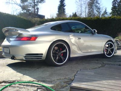

I have a 2001 996 turbo with 35 000 km.
Ruf ex. and Sportec ECU (Tiptronic)
After installation of Ruf exhaust and Sportec engine management i went 5000 km with no trouble. The car is running like h.... Max boost 1.1 bar.
Then the CEL lamp started to light. MAF sensor was changed and everything was OK again.
Then i discover under hard acceration (approx 1 bar 4- 5000 rpm in 3.,4.gear) that the ABS/PSM lamp went on.
This was reset when i started the car again.
First my dealer was assume air leaks in the pipes. No leakes were found but bad diverter valve. They were changed with newer type.
ECU has also been reset and loaded with Sportec SW again.
But still the ABS/PSM is lighten up.
The faul codes is P0103 MAF sensor ( has been changed 3 times so this is not a real error)
and 5525 Torque tranfer from DME disturbed at times.
When it throw the 5525 code is seems to be a defect ECU box, or ???
Spoked to Techart. They told me i must have an air leak. Maybe in air hose into / from the intercoolers.
The engine is running fine alle the time. Just my lack of ABS/PSM.
This is really frustrating. Starting to take my sleep away.
Any suggestions what to do next???
Any support will help a lot.. :clapping:
