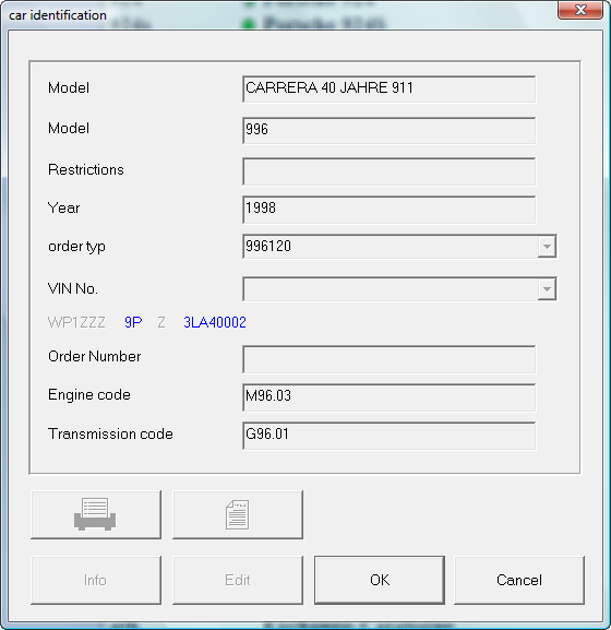

So if you have a PST2 or a Durametric and can read out the order type in the DME info section I would appreciate the help.

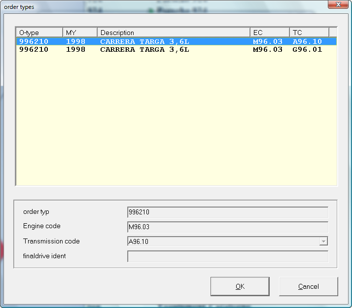

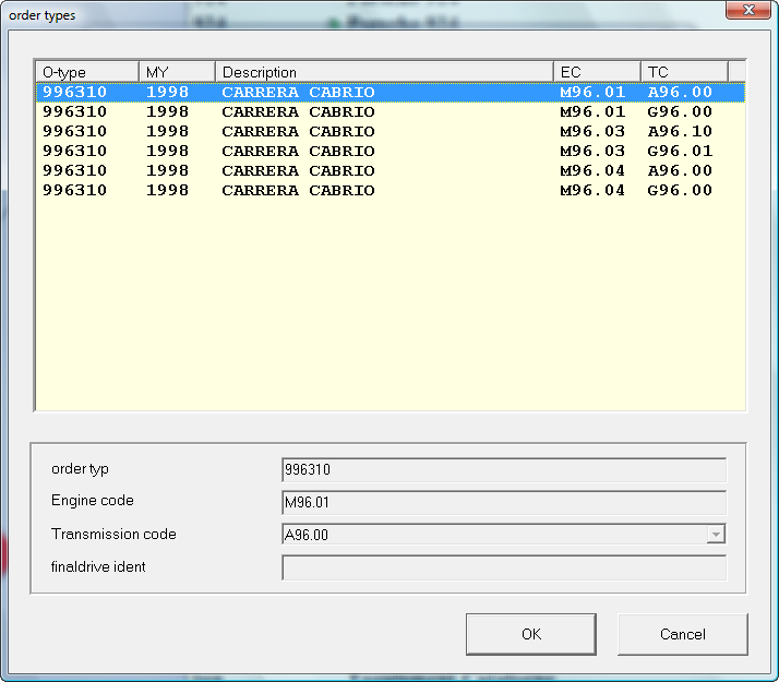

Thanks, I had the Boxster ones from you guys already. In the PET catalog when searching order types they all seem to come up with the similar information that is Carrera Cab and only some have a difference in the engine type. Most span M96.02-M96.04. So the PET doesn't seem to be that informative. For example I get the same result searching 996110 as I do 996410. This is why I was looking for the information directly from the people who have the cars.

The order code is also printed on the VIL on the luggage compartment lid and in the service book.
