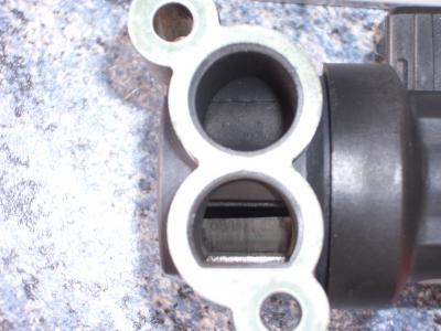

OK, 12V applied one way closed the metal shutter completely and the other way opened it completely so I presume this is working ok? In the unpowered position it is like in the photo attached.
Started the car (first time in a couple of days) and the idle/revs seemed normal, slightly higher than usual, 1000-1100ish.
After a very short run the idle was back to where it normally was in terms of revs 800-850ish and quality, lumpy.
Can I rule the ICV out and, if so, what's next?
