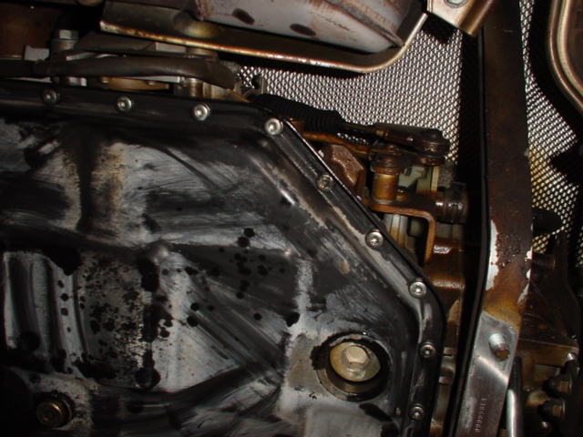

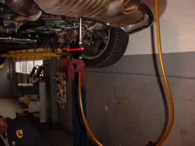

I was at my dealer yesterday and one of the mechanics was doing this.
The big plug is the fill and the small plug the drain, for the transmission.  I did not take a picture of the differential plugs.
uhhhhhhh :huh: OK.....the fill plug is on the bottom.....nice design......
Can they make it a little more complicated (?) and while they are at it and add in a healthy dose of pain in the butt. Guess I'll have my mechanic do this one. Trying that in your own garage looks to be a recipe for a lot of spilled fluids (besides the foamy kind). :beer:

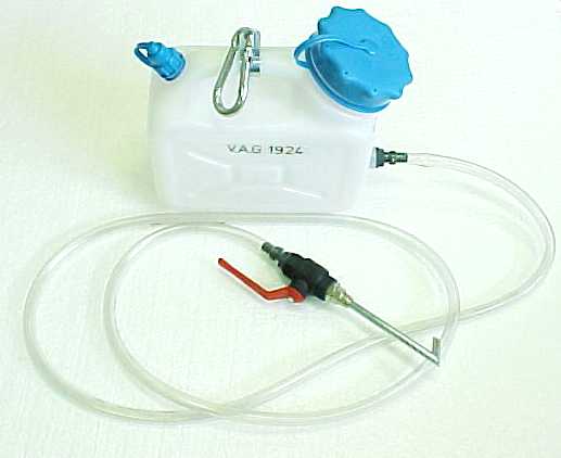

The Tiptronic has a filler port and a drain plund located on the bottom of the pan. The filling is performed using a VAG 1924 servicing tool.
See below, $289.00 at a internet site http://www.samstagsales.com/vwaudi.htm#trans . this is the same tool used by Audi, VW and Porsche for servicing auto transmissions.
Basically the OLD fluid is drained , New AT filter installed, Pan reinstalled, then refilled through the lower filler port until excess pores out the side vent. Then car is cranked and ran untill the temp reaches 30-40 C at which time the side port is closed.
There has to be DYI developed as Porsche dealers charge 200.00 + to do this work.
Below is the special tool used at the Porsche dealer.

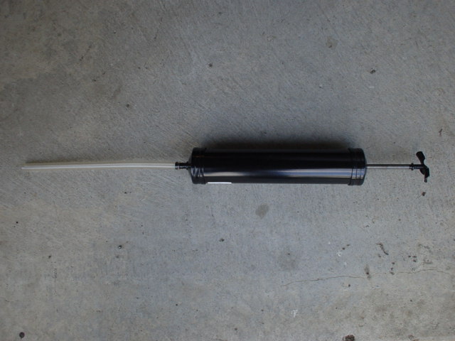

At a tech session we had a few years ago the mechanic added a bit of fluid. I do not have a picture of how he injected the fluid into the transmission fill plug (which looks like a drain plug) but it was just like this. You pull on the end of the rod to suck the fluid into the tool. Then stick the plastic tube into the fill plug and 'inject' it into the transmission. Looks like the official tool is gravity fed.

I found a similar pump that might work for this. The basic idea is that is gets filled from the bottom up the level at which fluid runs back out. A very large drip pan will make this less messy to say the least.
http://www.griotsgarage.com/search.jsp?searchtext=44480
The pump pictured in the ad will work for both extraction and dispensing of fluid.
