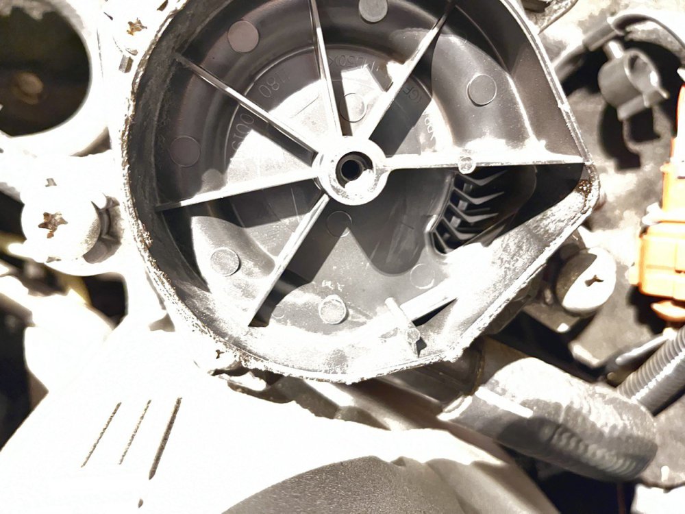

  5. Hi all, I have read multiple threads on this but my question is a bit unique. This code came up on my 04 S (128K Miles). I cleared it and it came back a few days later. The fuses all check out, the blades are in perfect condition, not debris that I can see. However, the filter (sponges) on the driver side is pretty torn up and it was a bit jammed together when I took the cover off. I opened the other side and although it was not as bad, it was a bit torn too. Here are my questions: 1. How are the filters supposed to sit inside the housing? They seem to be half circular so they can sit in various positions. 2. Are there replacements for them? Part number please. 3. I read in some other forums that one should just discard them as they serve very little purpose unless you are driving in a dusty place. Mine don't look that dirty after 20 years. Maybe some spots but not bad. Any experts that can opine on this? Thanks in advanced for your thoughts and hope your are enjoying your holidays.
