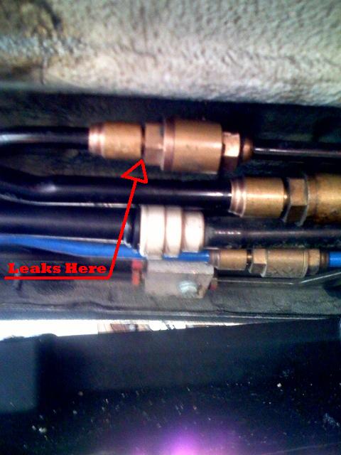

  24. Ok i found the source of my slow power steering fluid leak, Attached is a picture of the joint where the leak is coming from. How do i fix this, is there an O-ring inside that i can replace? I already tried to tighten the joint but it was already tight and i can see that the space between the nut and the line that goes in moves alot and that whatever sealed it inside was gone or worn so there is play at the area specified in red in the picture. If its O-rings, what size?
