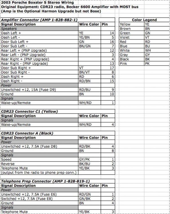

  1. Hi Dan. There is a ton of other information already posted on this site and the Pelican Parts website regarding diagrams, pinouts, etc which I’m guessing you may have already found? If you still have any questions though, I’m happy to try to assist as I’ve been researching this myself to try to get rear speakers fitted and working in mine with the 490 option pack (CDR-23 radio, Becker 6600 amp using MOST bus ) Good luck, let us know how you get on. BTW, I also previously posted this diagram that might assist you:

  7. Hi guys. I know that this thread is somewhat dated, but does anyone know if the amp pins for the rear speakers are always active for this Becker 6600 amp? My car only has the dash and door speakers and I am trying to figure out how to get the audio out to rear speakers so that I can fit them. I have the CDR-23 radio and it has no active analogue audio outputs. I’m hoping the rear speaker pins on the amp are already active and it’s just a case of finding somewhere to buy the pins to put into the amp connector. Also, thanks Loren for posting this diagram here. I have scoured the internet for months trying to find this! Thanks, Terry

  10. Hi guys. Thanks for all your information posted here, it’s been very helpful. I am trying to work out how I might install a pair of rear speakers on my 2002 986 that has a CDR-23 with MOST bus and the yellow C1 connector on it only has 4 pins with wires that are black, yellow, green and white with a red stripe. From the diagram you posted Sanjeev, it appears that these are titled ‘CAN comfort high’ and ‘CAN comfort low’, ‘wake up diagnosis’ and ‘key code in’ but I can’t find any reference as to what this means, do you know? I presume that all the audio is getting to the amp in the trunk via the MOST bus as I don’t have an audio out connector on the radio but I also can’t tell which amp pins are doing the audio out from the trunk as my manual doesn’t seem to cover the 2002 wiring diagrams. Would appreciate any advice if you have the opportunity please.
