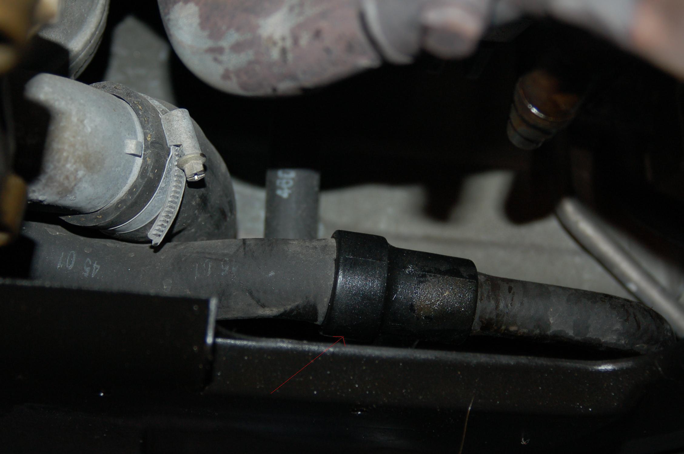

  10. This hose also appears to be leaking oil and based on its pattern I do not believe it to be from the RMS (although mine is leaking a little). It is at the rear of the engine below almost anything else. Does anyone know what this is and where is goes?
