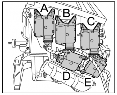

  9. Having an intermittent issue with air coming out of the left and right side vents in my 2004 CS. Only front A/C unit installed. I do not have a durametric connection cable. I have looked and looked but haven't really found any DIY regarding the replacement of the Servo Motors. Assuming that it could be two things. Either the A/C controller or the Servo Motor Flap Actuator. Since it works occasionally i am going to put my money on the Flap Actuator. Has anyone replaced one of these? I will gladly do a DIY write up if i can end up doing it myself. It looks like i need to do the following….. Removal of trim under dash. Removal of the immobilizer. Removal of the electrical system control unit. Is it possible to change a flap actuator without having to remove the last two items? Looks like there is 5 actuators. Which one controls the side vents? Thx

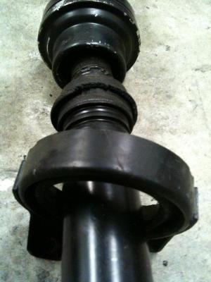

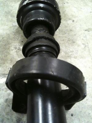

  21. Just did my cardan with a replacement from Colorado. Great service. Here is the old one.....at 72,000mls
