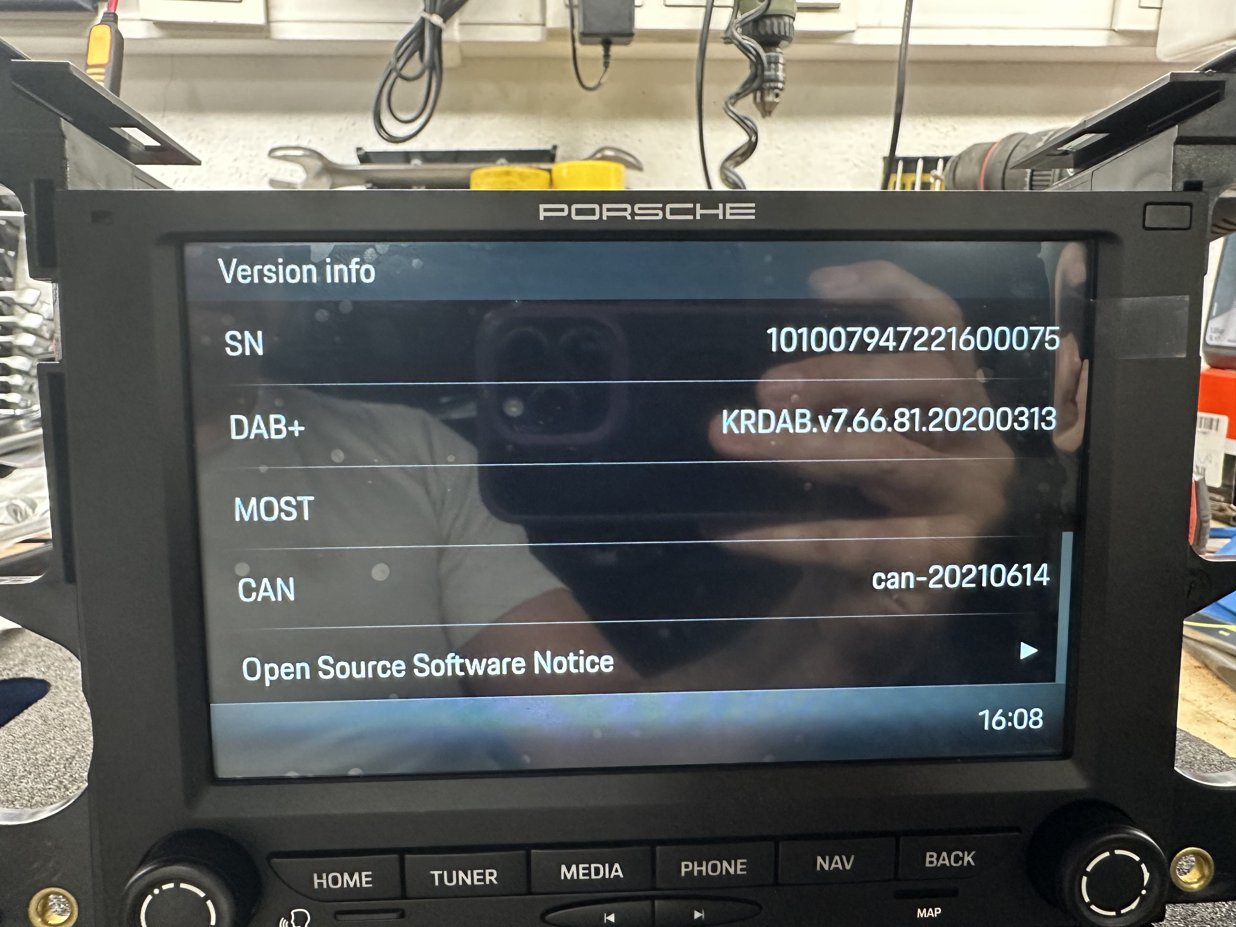

  5. To anyone who installed a PCCM+ in a MOST 996/986, when you initially attached the MOST box, could you see red light inside the socket when the radio powered up? I have no red light shinning at all. And, for anyone who has currently such a setup, can you check whether the MOST version number shows up in the version info screen? For comparison, I'm attaching a photo of my version info screen, MOST version empty. It appears the PCCM+ does not detect the MOST box. I read about a lot of cases where the MOST box was DOA, I'm wondering if I have another such case. My car is non-MOST and am not going to use it initially at leat but given I have an aftermarket amp with a Toslink input (and only speaker-level inputs, no line-level) I was thinking about getting a MOST to Toslink converter and ensure a fully digital path to the amp. The way it will be now, the PCCM+ converts the iPhone digital stream to analog, amplifies it to speaker level and then it goes down the line to the amp, where it will be digitised again, processed by the DSP stage, converted back to analog and amplified again and finally sent to the speakers. So, I was definitely considering using a fully digital path but that requires a working MOST output. So, can someone please check their "Version Info" screen and see if their MOST shows a version or is also empty, despite working fine?
