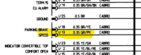

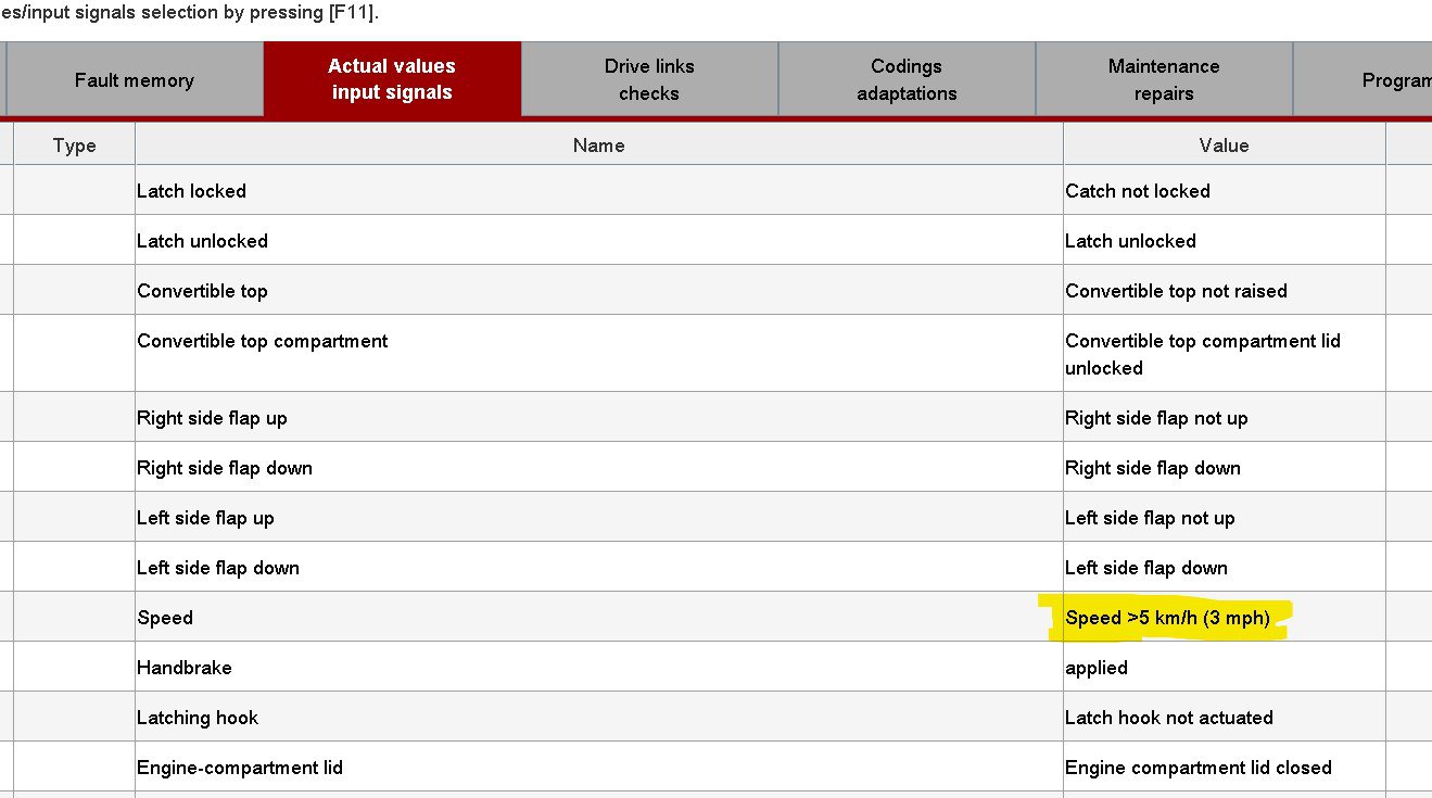

  1. My convertible top has never worked so today I started testing all systems. I reset the lid potentiometer to 6.2k, manually opened the front latch and told the PIWIS to perform a calibration. The windows begin to lower but they stop moving after a second, triggering the dreaded "Function inactive, end position not reached" error. I tested all of the microswitches and got good results. I moved on to the "Drive links checks" and can move everything (except for the side flaps) but not for more than a second before receiving "Function inactive...etc" errors every time. For some reason the convertible top ECU is receiving an actual speed value of "Speed >5km/h (3mph)". (Highlighted in yellow on the attached screen grab). Is that enough to halt every attempt to perform calibration or drive links checks? I found a DIY from Loren (see below) that said to cut the GREY/ PINK wire leading to the top ECU if you want to eliminate the speed check for top operation. I checked it against the 2000 wiring diagram and made sure it was pin 13 on connector 1. CUT! And there was no change in the Speed value. Still reading above 5km/h - 3mph with the car standing still, parking brake on. Is there something else that will cause "drive link checks" or calibration to last only a moment before returning a "Function inactive, end position not reached" error? Thanks! )

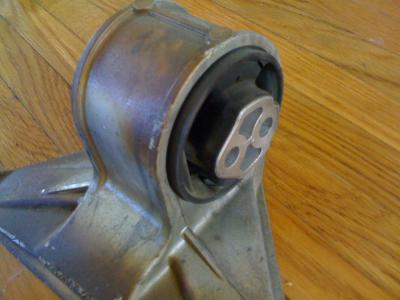

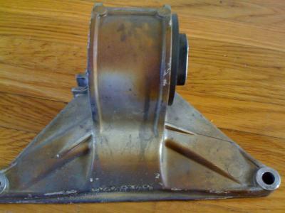

  10. My apologies for adding to this old thread but I'm seriously envious of everyone who managed the engine mount replacement with minimal trouble. I have not been so lucky and am looking for some help. Witness the attached pictures. With my new mount bolted to the frame I am now about an inch away from lining up the mount with the engine. Examination of the old mount shows that not only was the rubber seriously torn from the mount but pushed heavily to the left side of the car. (When I say left or right I am looking forward from the rear of the car). UPDATE: I installed the frame mount upside-down. This is what happens when you don't do the job all in one go. Car now back together with minimal fuss. Next time I'll take pictures during the entire process for reference. Of course there will be no next time because I hope I die before I have to spend that much time underneath my own car cursing myself. -bill 1998 Boxster 2.5.

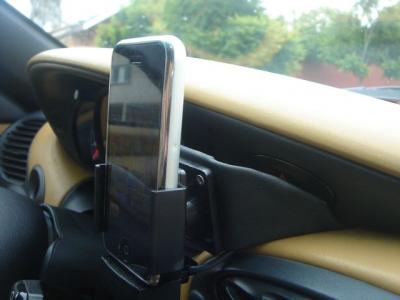

  12. The audio quality out of the iPod portion of the phone is crystal clear. The RFI from the phone communicating over the air is another story. From this position on the dash an occasional light ticking can be heard through the car speakers. Pull it out of the cradle and stick it anywhere near the Becker and the racket is terrible. I put a layer of aluminum foil between the phone / stereo and this eliminated all of the noise but then wrapping the phone up like left over food isn't really the look I'm hoping for. Pulling the Becker and wrapping it in an adhesive RFI foil like this might be the next step. Putting the phone back into it's orginial position (jammed into the far right corner of the passenger seat) also eliminates all RFI. This is a work in progress.

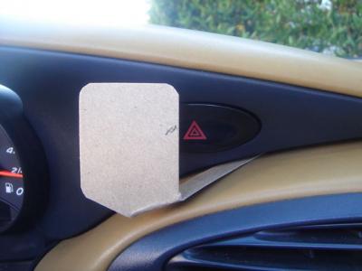

  13. I've been looking for a car mount for my new iPhone. With it's big fat touch screen connected to Google Maps I felt like this would be the first phone I'd like in my line of sight while driving. Unfortunately all of the mounts built especially for the Boxster put the phone at hip level. I don't want to glance toward the floor of the vehicle to see who is calling. I also didn't want a suction cup-gooseneck combo snaking it's way down from the windshield trailing a bunch of cords. The order of the day was; a drop-in mount containing iPhone power and an audio connection to the AUX in on my Becker CDR-220. I've had the dash apart twice; once to clean the insides of the speedo/tach faces and again to install the OBC hack. While in there I thought there might be just enough room on the right post for a piece of metal. You can see my first mock-ups cut out of cardboard below. I laid these templates out onto some 1/8" tin and cut them with tin snips. I quickly realized that even when doubled, the bracket was going to keep my iPhone wiggling back and forth with every bump in the road. I cut a second brace in a slight curve to eliminate fore and aft movement. I imagined the graceful curve emulating the designed curves of the interior pieces. Then I wrapped the whole mess in automotive black vinyl with good old 3M spray-on glue to keep it in place. It's not beautiful. Bolt on the Dice iPod cradle and from anywhere but the drivers seat, I've created a monster. The whole thing runs into the AUX channel of the Becker via Belkin's Auto adapter. Everything is hard wired under the dash and turns on with the key. Power, audio and cradle problems temporarily solved. Hate? Access to the hazard switch is a reach around and the whole thing really takes over the dash. The Dice cradle only comes with plastic inserts for iPods so my phone is still sort of loose although they've promised a new insert for the iPhone (some day). Sure would be nice if they came out with a cradle with a phone mute line and a working RCA video / audio out. Love? I haven't destroyed the interior; this can all disappear without a trace when someone answers my iPhone in-car dreams. It's perfect placement for navigation, in-coming calls and reading e-mail while stuck in traffic. I am cable free once again. I never built anything like this before and I'm showing you so that either you'll build a better one or at least point me in the direction of someone who has. -bill
