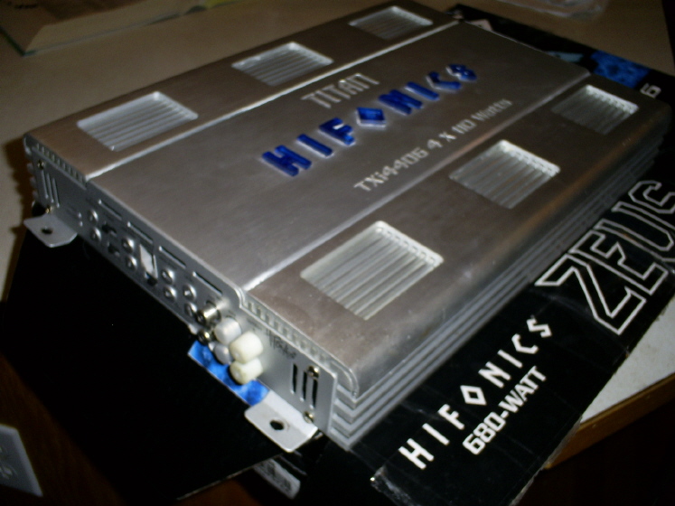

  10. with a new HU,MOST gotta go. I would consider getting a mosfet 4CH amp with built in x-overs. HU can drive the dash, 4Ch amp can power up the doors/subs,,,

  13. Yes hifonics, power from the gods
