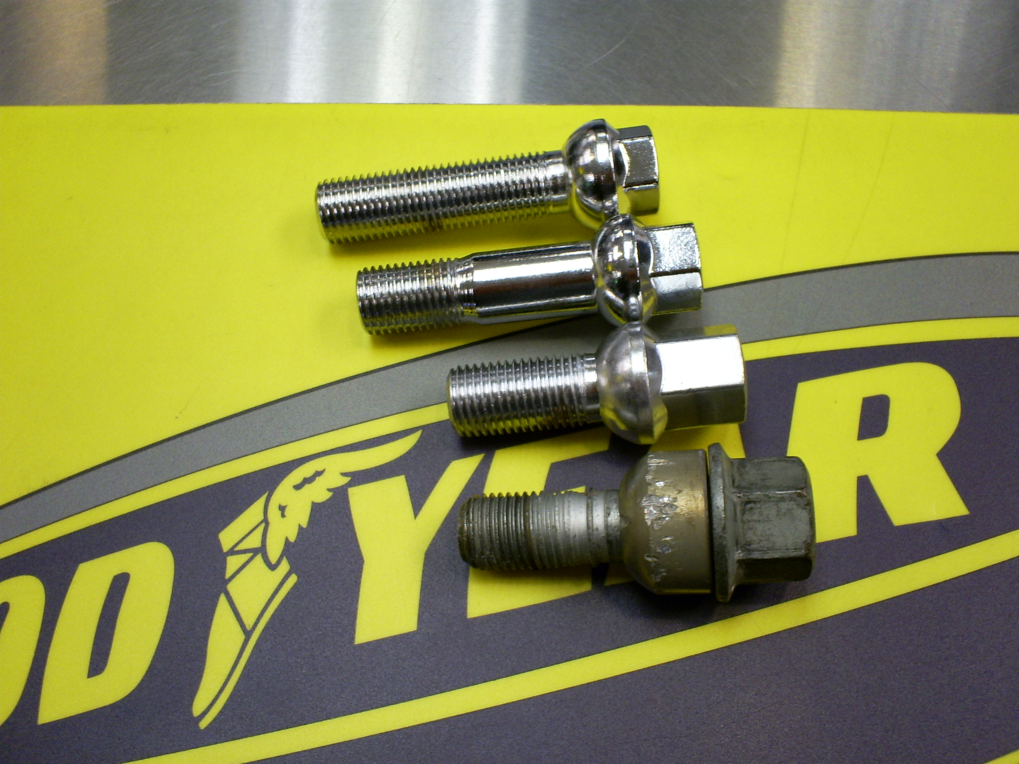

  12. Anytime,man also will need longer lug-bolts. let me know when U need it.

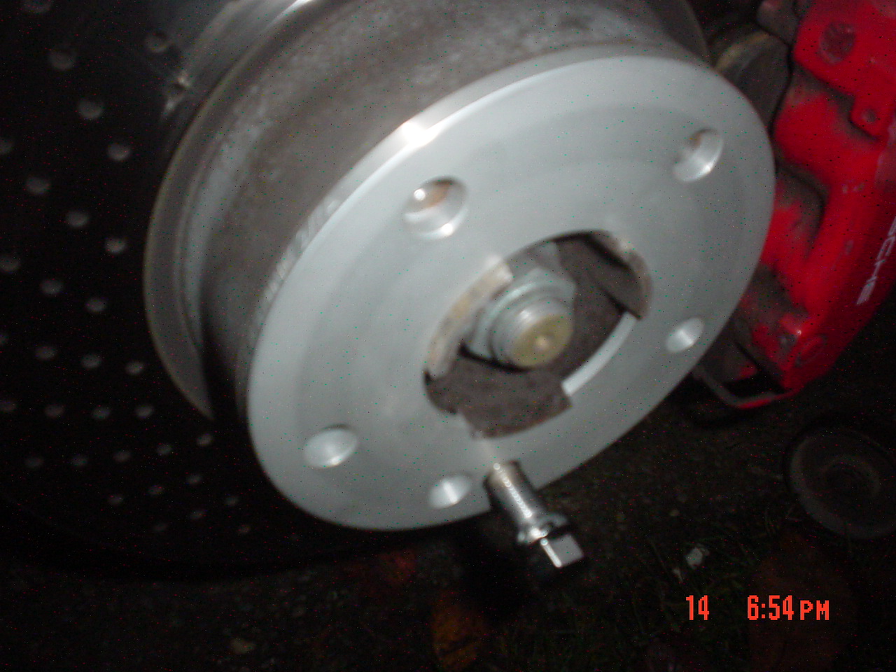

  14. U would need 235/35/19F 295/30/19R most likely will need 2 pairs of 7mm/F & 14mm/R hub centric spacers.
