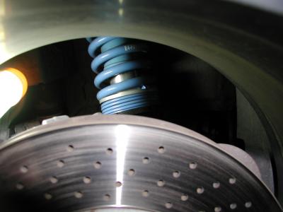

That was the directions that I was missing! Perfect! Now for a second question.... Never having seen these installed on a car, does this look normal? There's a secondary spring on the PSS10's and with my car sitting on the ground it's practically bottomed out, doesn't look like that secondary spring can even move. Is that normal? I had them installed at a very reputable local shop, owner was even a crew chief for a Porsche Cup car... the only reason I'm questioning is that when I wentto adjust the rears (Thanks to you Loren) one side of the Bilstein adjuster was maxed and the other was Full Soft... seemed like a pretty rookie mistake. -
