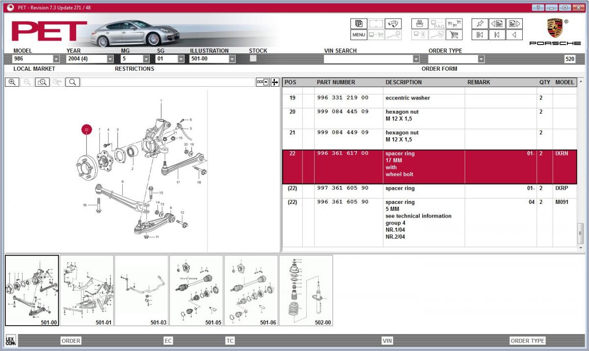

  17. Show them the part numbers for the spacers and bolts from multiple Porsche's that shipped from the factory with them... Picture is a little big, but I wanted you to be able to print it off and SHOW them, the Boxster's actually shipped with an available spacer and longer lug bolts.. You can see there were multiple options. A 17mm spacer and a 5mm spacer.
