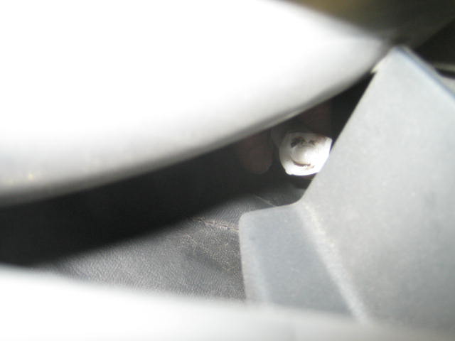

  11. Hi everyone, I am a complete top newbie. After spending the last two days on this forum reading through the threads here, I think I have somewhat diagnosed the problem. (pictured below) Can you guys please tell me: 1) What this part is? I believe it's #10 on the parts image below. 2) How much and where can I get it? 3) Are there any special tools I need for the fix? 4) I am currently using one of the guides on here on how to manually open the top from the closed position, but does anyone know if there's a thread on how to fix this part? 5) Do I need to order any other parts other than part #10 (if that's the one?) It's broken on both sides. Sorry for so many questions, but I just wanted to make sure I had all the materials necessary before I begin the fix. I need to use my car everyday and don't want to unhook the ball joints twice to put the top into service position. Thanks everyone!! - Mike P.S. I have a 99' Boxster
