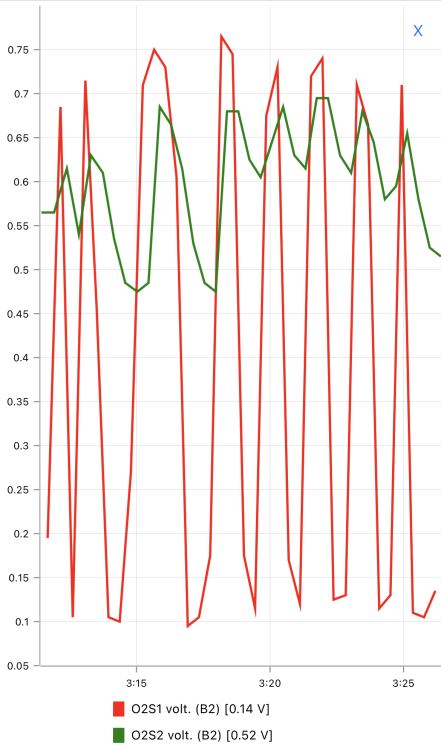

  9. Thanks for the help guys. I suspect bank 2 cat is bad. I just wish that it was good enough to give me a ready state to pass smog. Not quite ready to give up hope but getting there.
  10. Thanks. It is still confusing me why, if the cat is bad, that I am not getting the associated code. Just that the monitor is not ready.
  11. I typically use Durametric to read the values, but happened to have a wireless reader plugged in today so I can show you the readings. As you will see, Bank 1 looks good, O2 sensor after cat is steady (green line). Bank 2 O2 sensor after cat (green line) is oscillating, not as much as pre-cat (red line), but certainly less than ideal.
