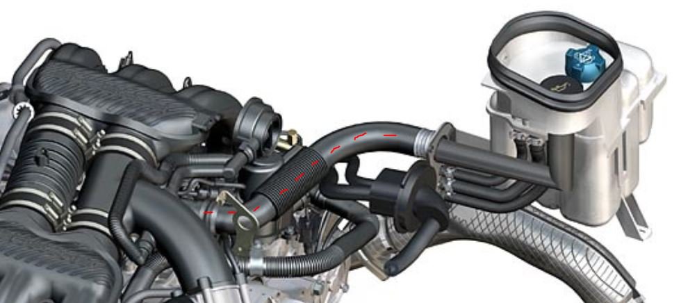

  13. This is not your exact model, but gives you an idea of what the hose (red-dashes) looked like before:
  14. My guess is that the previous owner cut out the flexible section of the tube and then capped it off. It was probably torn/leaking in that section and that was his "solution". There are probably some MacGyver solutions to rejoin the tube sections, but I wouldn't personally mess with it. I'd just put the right part in there this time around. I replaced this part on mine many years ago after I damaged it during some transmission work. I don't remember all the details, but I also don't remember it being particularly difficult. You can use screw-type hose clamps instead of the oem ones which require the hose clamp pliers ($30 on amazon for a nice one if you prefer to go that route).
  15. Looks like you probably need a new oil hose 99610725403. Porsche part is $64 on rmeuropean. Other decent sources are PelicanParts or Sunset Porsche Parts. If you haven’t yet, search the web for the boxster catalog of parts. Should be named KAT520_USA_986_04_KATALOG. It will have the diagrams you need to identify which parts you need, along with part numbers. You might need a couple more things to solve your issue.
