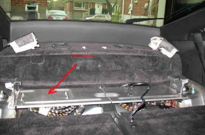

  15. You both got me! I took of this black panel once to remove the round cover to get access to the fuel pump ???? I guess the fuel tank is from the top down to about 18 inches ??? Ok just saw your picture Loren and thanks for cutting your car to prove a point but you did not have to If I am wrong delete everything so we do not confuse anyone Loren. Thanks
  16. Be very careful, it is the fuel tank!. The tank is big plastic container. (see pics) And I don't know how much space you got between the wall and the reservoir. Again be very careful....

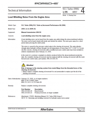

  19. Cannot open the video but check your steering pump reservoir level and also take a look at this TSB...
  20. Look at this TSB. Depend if it goes away after depressing the clutch.... Also take a look at your steering reservoir level....

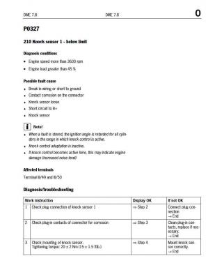

  22. For the other part of your question, here's a copy of the OBDII manual . According to the OBDII manual it is related to wires, sensor or sensor loose on the engine....

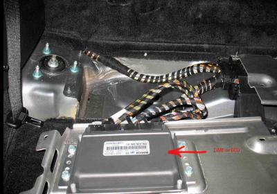

  23. Can I help with this one.... DME location see pics. I cannot help you with the wiring since I only got the 2002 wiring diagram and on the 2002, the wires goes directly to the ECU from the knock sensors...
