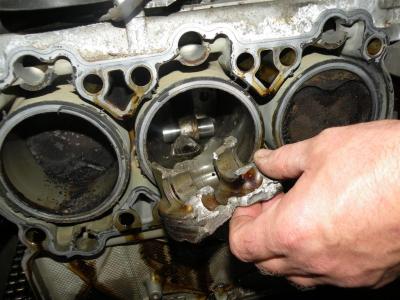

  20. Sounds like a classic MOF#14 to me.. Piston failure. Been there, done that have the pieces on the trophy shelf to prove it.. There are lots of things that have this same set of symptoms, like a slipped sleeve, D chunk failure, etc, etc,etc..
