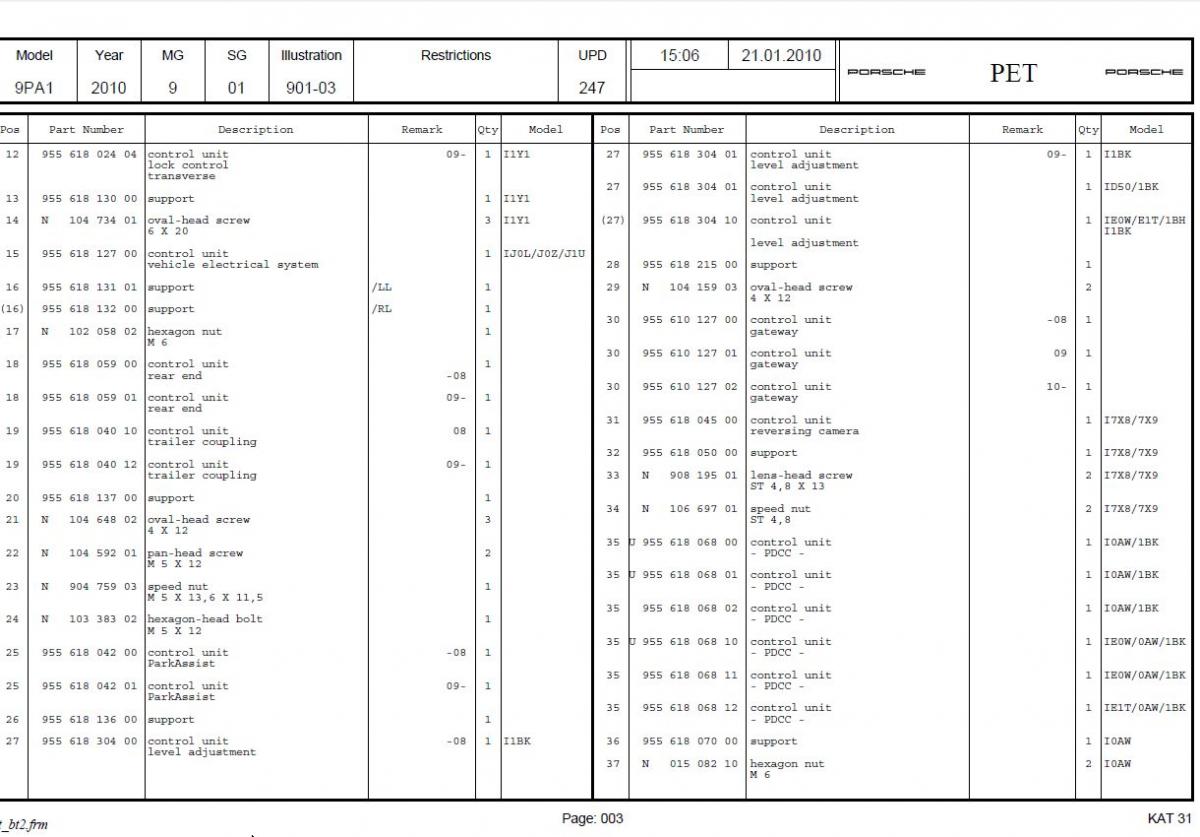

  1. l o l dude cheers! Loren..i recognize the codes made due to low or disconected battery but the problem is that there are situation wich can not be reproduced anymore (due to the lack of some control modules) and that's why i preffer not to erase the all fault codes yet. if you looked over the submited log you will see that there are refference about many control modues that does not signal.. it intrigues me the mesagen in the end of diagnose (wich can not be reproduced anymore i don't know why was not stored like the rest of the log) wich state that there are 4 control modules wich does not repond , dme , transfer case and i try to find out wich are the "electrical system " and "off road stabilizer" control modules wich durametric tool also reffer that they did not respond. i have looked in the PET Porsche Cayenne list of all ecu's but no sign of them..maybe you can highlight them form me. A mention is that after looking under the plastic cover on the right side of wipers i have seen that there are 2 connectors with not ecu's i assume that 1 is for the engine ecu and the other... bellow list of ecu's..

  3. 2008 accident cayenne turbo.import arrived today,put new battery but not starting ,not rolling,diagnose with durametric ,resulting that 4 modules are missing dme electrical transfer box off road stabilizer it should refer to dme = engine ecu, transfer box=automatic transmission ecu,off road stabilizer= level adjusting ecu? we have looked in the wiper area-passenger side and there are 2 connectors empty outthere, i assume 1 is for the dme ecu questions. is there somewhere a service workshop-repair manual for the cayenne too? where are all of those control units located on the car? are those control units interchangeable with other years cayenne , maybe vw touareg , even if not all of them , partially.. i try to repair this car so any thought's appreciated,bellow the durametric full scanlog: Short Test Porsche Stability Management (PSM/ABS8) Current Fault Codes 668: Vehicle voltage terminal 30 Upper limit value exceeded 668: Vehicle voltage terminal 30 Value below lower limit value 1314: DME control module No signal/communication 1310: Level control module No signal/communication 1826: Power supply steering wheel electronics Airbag Current Fault Codes 1739: Sensor for airbag (passenger) Open circuit 588: Driver's airbag ignition circuit stage 1 Upper limit value exceeded 589: Passenger's airbag ignition circuit stage 1 Upper limit value exceeded 1587: Driver's airbag ignition circuit stage 2 Upper limit value exceeded 590: Passenger's airbag ignition circuit stage 2 Upper limit value exceeded 654: Belt tensioner ignition circuit driver's side front Upper limit value exceeded 1211: Belt tensioner driver's side rear Upper limit value exceeded 1212: Belt tensioner passenger's side rear Value below lower limit value 1590: Disconnecting relay Upper limit value exceeded Instrument Cluster for Cayenne Current Fault Codes 562: Oil level sensor - Open circuit/short circuit to B+, test conditions are not-completed, fault is currently active and is not causing a DTC light 1299: Gateway - No signal/communication, test conditions are not-completed, fault is currently active and is not causing a DTC light 1310: Level control module - No signal/communication, test conditions are not-completed, fault is currently active and is not causing a DTC light 1314: DME control module - No signal/communication, test conditions are not-completed, fault is currently active and is not causing a DTC light 3294: Headlight control unit left - No signal/communication, test conditions are not-completed, fault is currently active and is not causing a DTC light 3295: Headlight control unit right - No signal/communication, test conditions are not-completed, fault is currently active and is not causing a DTC light Steering wheel electronics No Faults Found Porsche Keyless Entry Security System (KESSY) Current Fault Codes 1176: Immobiliser key Implausible signal 668: Vehicle voltage terminal 30 Open circuit/short circuit to ground 87: Terminal 30 (start enable) Open circuit/short circuit to ground 230: Selector lever position switch >P< Short circuit to ground 1314: DME control module No signal/communication 1299: Gateway Please read out fault memory Doors and Rear Hatch No Faults Found Seat Memory Driver Current Fault Codes 668: Vehicle voltage terminal 30 Value below lower limit value 1898: Steering column adjustment sensor axial (Hall sensor) Short circuit to B+ Gateway Current Fault Codes 0214: Power supply Value below lower limit value 0538: CAN comfort OFF Open circuit 01D2: Steering column switch (with electronic unit) No signal/communication 0519: CAN Infotainment Faulty 01CB: PCM2 No signal/communication 3CDE: Headlight control unit left No signal/communication 3CDF: Headlight control unit right No signal/communication 0522: DME control module No signal/communication 051E: Level control module No signal/communication 01D7: Control unit for electronically controlled damping (EGD) No signal/communication Air Conditioning Current Fault Codes 819: Air-conditioning pressure sensor Open circuit/short circuit to ground Park Assist No Faults Found Panorama Roof No Faults Found Tow Bar Current Fault Codes 532: Power supply Value below lower limit value Seat Memory Passenger Current Fault Codes 668: Vehicle voltage terminal 30 Value below lower limit value 2341: Fore-and-aft adjustment sensor Short circuit to B+ Automatic Tailgate Current Fault Codes 3234: Function restrict. due to critical vehicle electric. system condition 532: Power supply Value below lower limit value 1336: CAN comfort OFF No signal/communication 446: Function restricted due to undervoltage Value below lower limit value Windshield wiper No Faults Found Tire Pressure Monitor (TPM) Current Fault Codes 1312: CAN drive Please read out fault memory 1317: Instrument cluster No signal/communication 2214: Tyre pressure warning Tow Bar Current Fault Codes 532: Power supply Value below lower limit value
