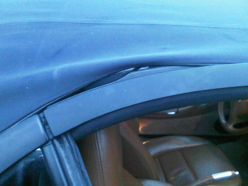

  19. yes this is the right cable. I fixed it here http://forums.rennlist.com/rennforums/996-forum/574384-convertible-top-not-folding-closed-quite-right-pics-solved-2.html
  20. FIX to the PROBLEM POSTED HERE http://forums.rennlist.com/rennforums/996-forum/574384-convertible-top-not-folding-closed-quite-right-pics-solved-2.html
  21. Quick update: It is the tension cable that goes along the passenger side. I can pull it down - there's basically no tension (it's slack). What's the part number of that cable? Thanks
  22. Thanks - am really hoping it's that simple - but what am I looking for Pic or diagram would be helpful... TIA
  23. It looks like the cable (inside the vinyl sheath) may be stretched or has become "unanchored" from where it is screwed in under the rear of the top frame (base of the B-Pillar on a Boxster). Not sure if this will be helpful, but take a look at this DIY for a similar problem with Boxsters, your 911 may have similar mechanisms at play: http://sites.google....fallintoguidech If it does help with your 911 top, let me know and I can add a few words to the DIY for 911 owners. Regards, Maurice. Maurice this is fantastic. I will have a look later today
