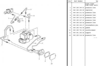

  6. I am not sure I would call it a failure, but it definitely was faulty. I disassembled the valve and found a large amount of grit inside. There is a spring-loaded mechanism inside which limits flow in one direction once a certain pressure has been acheived. New valve, no noise, and better braking performance.
  7. I was finally able to look into this more. It appears that there is a brake proportioning valve off the master cylinder of my '00 S that has failed. When the pedal is depressed, this valve gives out a loud "click." It's part number 2 in the attached PET diagram. part 986.355.305.00. I verified that the sound is not coming from the master cylinder or brake booster, which is also not full of water. Tool Pants / Loren, have you heard of this part failing? Fortunately it is not expensive, but I find it a strange failure. It looks like the valve can be disassembled, so I'll have to take it apart when I get the new one.

  19. I have a 2000 Boxster S, US Model, 6-speed trans. I recently replaced my MAF. The MAF that was installed had the part number: 0 280 218 055 and 986 606 125 00 The part numbers of the new one are: 0 280 218 055 and 986 606 125 01 After installation, I cleared the CEL with a scan tool and the car runs correctly (i.e. it no longer stinks and it revs out properly) except for the fact that it seems to have a hesitation or a soft spot after each shift. Almost as if I'm backing off the throttle for a moment after I engage the next gear. No stuttering, just a slight loss of power. No codes stored in the computer. Do I have to unplug the battery for a while to have the ECU re-adapt to the new MAF? Thanks, John

  22. I'm having a strange issue that I'm wondering if anyone has come across. The brake pedal has for lack of a better term, a slight "notchiness" to it. It's as though something is binding and causing a feeling that the pedal catches, then releases. It is audible as well - it causes a reasonably loud click when it occurs. I inspected the pedal mechanism and the booster and with an assistant pumping the pedal I can't feel it in the linkage or the booster - but I feel it in the high pressure brake line out of the master cylinder leading to the ABS unit. The brakes function normally, I have proper brake assist and the ABS seems to work correctly. Has anyone ever noticed this before? I haven't checked to see if a caliper is binding, and I flush the brakes once per year. Would air in the ABS system cause this?
