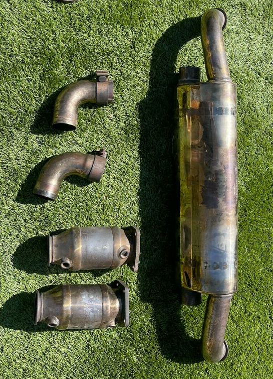

  12. Is this what the OEM GT2 996 exhaust looks like?
  13. Loren does the GT2 exhaust have any drone? I want a bit more sound but generally dislike aftermarket. (except Cargraphic in some models)

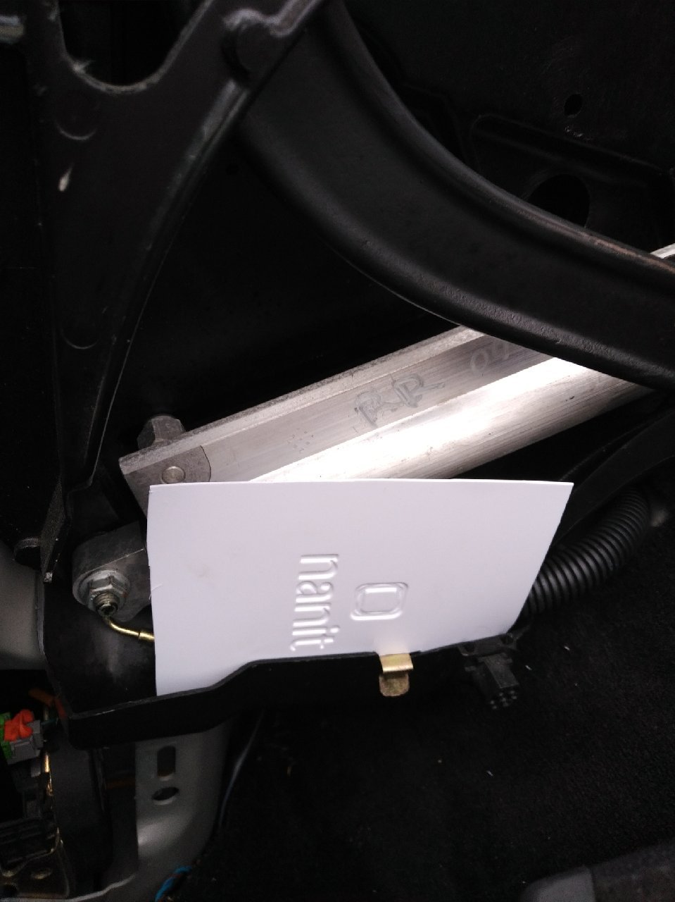

  22. I just took off my two rear passenger panels to check the drains. They were actually mostly clean and one had a missing splash guard (made replacement from white semi-stiff plastic packaging). I used a toothbrush and simple green to clean all of the rubber trim around the clamshell and the "chutes" into the drain bins. Not sure why my passenger rear rug is wet. Could of been that the drains are partially blocked and I flooded them using a mechanical carwash. I still need to remove the rear wheels and splash guards to check the exit ports. Highly recommended that you spray both sides of your cab pistons with Finish Line Max Suspension Spray. I had it from servicing the spoiler and wow what an improvement. My top stays in the service position when before it slowly crept back or forward. Both sides of my "corrugated tube" were in good shape.(seen to right of the white plastic) Should not be split and also have some grease and o-ring where it connects up top. Then goes down and clips to feed into the bin. More diagrams and pictures:
