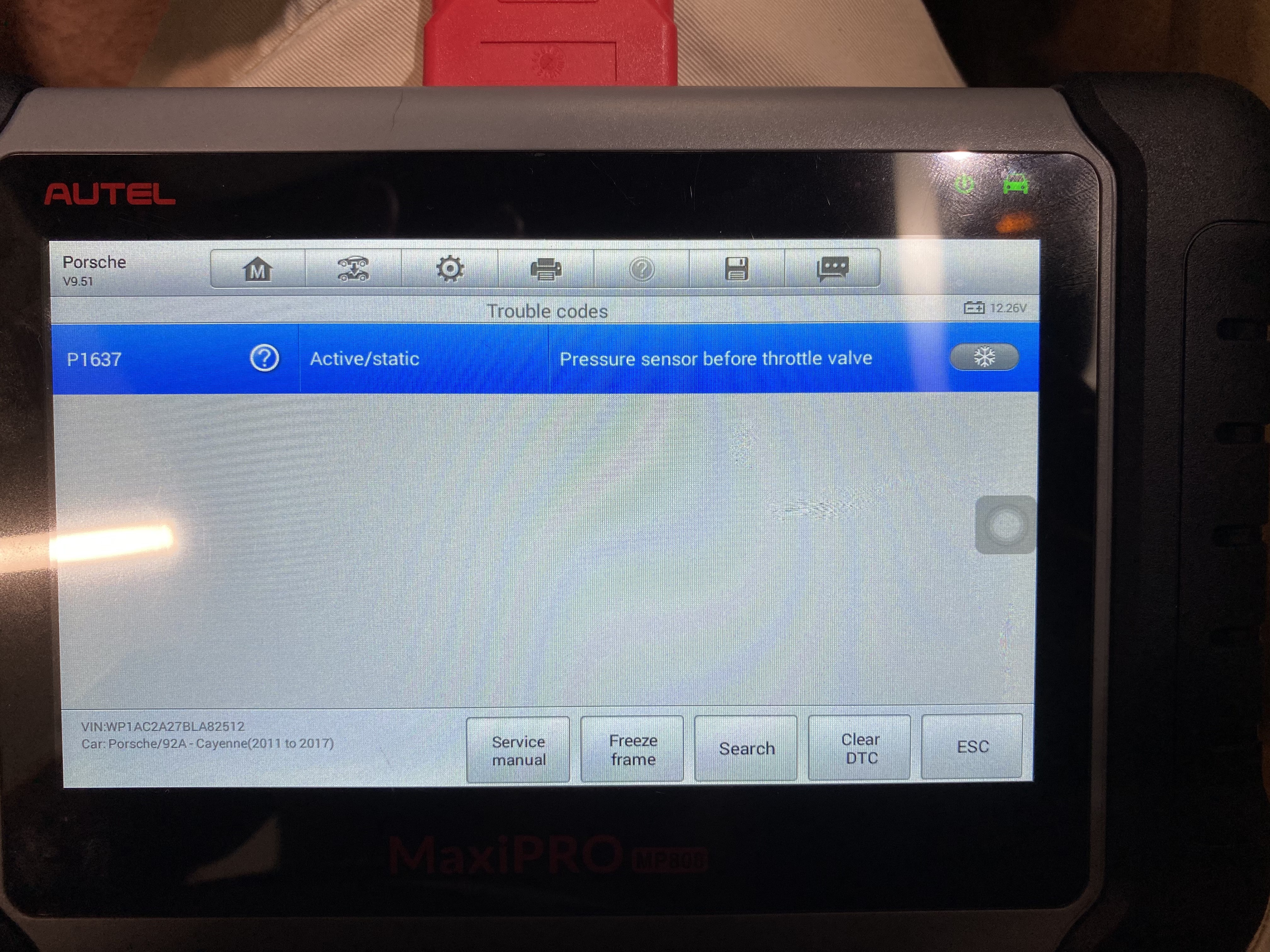

  5. Update on this topic. I drove to work the other day with the CEL on and I noticed the boost gauge was showing .1 bar while at idle and would fluctuate sometimes to 0.0. I am wondering if I have a faulty sensor. The car ran well and idle was smooth and RPM's did not fluctuate. I only wished I had my scan tool with me to read values. My next plan is to drive the car with the scanner hooked up and monitor the values while someone else is driving.
  6. JFP thank you for your response. Excellent point I assumed it had never been flashed but that is just an assumption based on a guess. I will hook up my Autel and take a look at the pressures. What is the best way to tell if you have a tune?
  7. I have a 2011 Porsche Cayenne Turbo. I have owned the car 2.5 years and about 2 years ago I got this code and erased it and it did not come until recently. I did some research and assumed it was the Manifold absolute pressure sensor just prior to the Throttle body. The part was fairly inexpensive at $30 (0 261 230 042 Bosch) I decided that was probably it and installed the part. The light came back within a few miles of driving and if I clear the code it comes back right away although it is passive at first (does not trigger CEL). I also ordered the similar part by accident that attaches to the back of the manifold. It takes talent to order the wrong part even though you wrote the part number down. I decided since I had that part already to go ahead and install it and it made no difference. Does anybody have any experience with this one? The car is pretty much bone stock other than the Apple car play I installed on the PCM about 6 months ago. I have 120000 miles and I perform all maintenance and repairs on it. I have an Autel MaxiPro mp808 and it has pretty close to dealer level software and has the ability to read live data. My next plan is to trace the wire in the harness to look for any defects but I think this will require intake manifold removal. Anyhow I realize from reading these posts that we have some extremely intelligent guys and gals on this forum and I would appreciate any feedback or thing I should look at.
